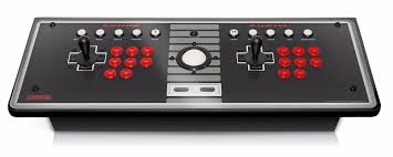

Hey folks ... So I got my RecRoomMaster Cabinet in and assembled with the 2 player Xtension Emulator Edition controller board. Up until now I've been testing my build with an inexpensive Logitech controller and mapped via joytokey.
The board is supposed to be preconfigured for MAME and Windows, but because I'm also using RetroArch and a few other necessary emulators my preference is to set a configuration through RL globally. Any guidance on where I might find a tutorial, or other guidance on the right way to get this all set up? There seems to be a lot of piecemeal stuff on how to do it but nothing I found that walks me though the right way from beginning to end. Thoughts, help, guidance?? Anyone want to come to MD and I'll buy the beer :)

Thanks for the detail around the explanation. My Xtension controller came with the cabinet purchase through RecRoomMasters and, other than indicating that it is preconfigured for MAME and windows navigation (it works fine in both) didn't provide any additional detail. I'm going to give them a ring in the AM for any other detail they can provide, and I'll spend the time to understand the data you provided. Right now it does not work in HS although I can launch games through RL and use it just fine in Mame and to a lesser extent with some of the other emulators.
I'm sure it is just going to be a learning process and I'm being impatient about it now that I have everything in the cabinet .... The actual controller is shown below.
