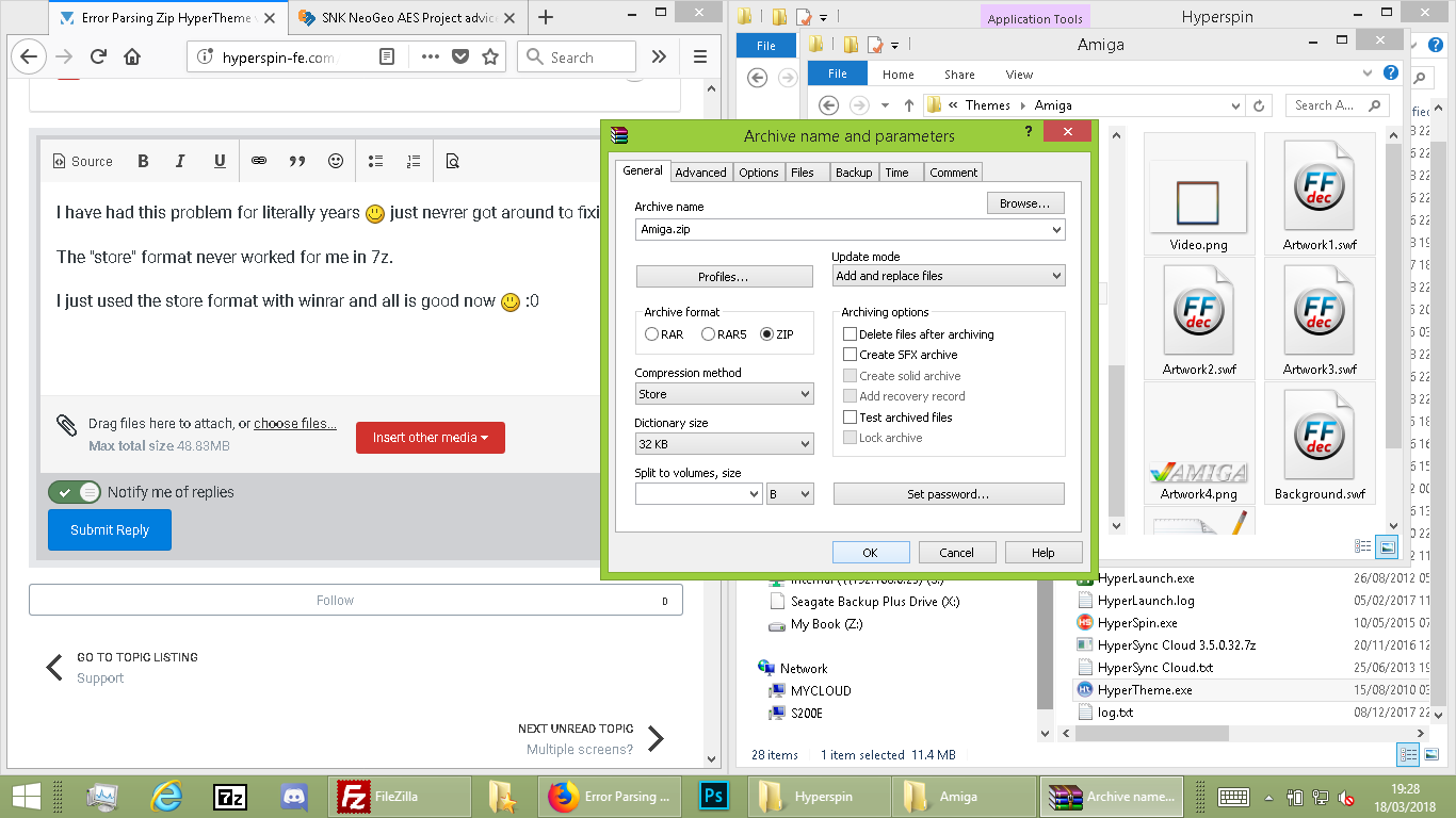

thatman84 Posted March 10, 2018 Posted March 10, 2018 I was told to change me 7z settings to store iirc but I still couldn't get it to read my zip files Hyperspin 2.0 Latest Download Hyperspin 2.0 Documentation -------Pre Hyperspin 2.0 Below---------- HS Android Overview & Install HS Android Base Pack Download My Tutorials
thatman84 Posted March 18, 2018 Posted March 18, 2018 Sorted the issue by using winrar to zip my theme up. Hyperspin 2.0 Latest Download Hyperspin 2.0 Documentation -------Pre Hyperspin 2.0 Below---------- HS Android Overview & Install HS Android Base Pack Download My Tutorials
Fizen Posted March 19, 2018 Posted March 19, 2018 I get that error if I've manually edited the zip after making the theme (ie adding wheel art file). Unfortunately, I dont know of a way to get it to work again once its giving the error. I tend to make a backup pf the original file and make the changes there so that HT can still open the original. I have had an issue where even the zip wouldn't open saying it was corrupt then needing to use winrar or 7zip to open it.
thatman84 Posted March 19, 2018 Posted March 19, 2018 Have you tried the winrar settings above after you manually edit a zip? Hyperspin 2.0 Latest Download Hyperspin 2.0 Documentation -------Pre Hyperspin 2.0 Below---------- HS Android Overview & Install HS Android Base Pack Download My Tutorials
