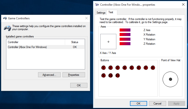

windows sees your 360 controller as a joystick with button numbers
example
Button 1 = b
Button 2 = a
Button 3 = x
Button 4 = Y
ect
this is an image for the One controller but you get the idea
xbox_streaming_-_game_controllers.png?it
if you connect a PS/360 controller to your PC and map all your button numbers to the corresponding letter similar to this
you can buy any generic joystick encoder and wire the button number to your preferred key.
that is what I did because of Pinball FX2
example using this picture
Pinball FX2 uses Left and Right shoulder buttons for the flippers :
L Flipper key was wired to button 3 input in the joystick encoder
R Flipper key was wired to button 4 input in the joystick encoder
I did not have to use an external program to remap the keys because my button wiring matched the 360 controller layout
