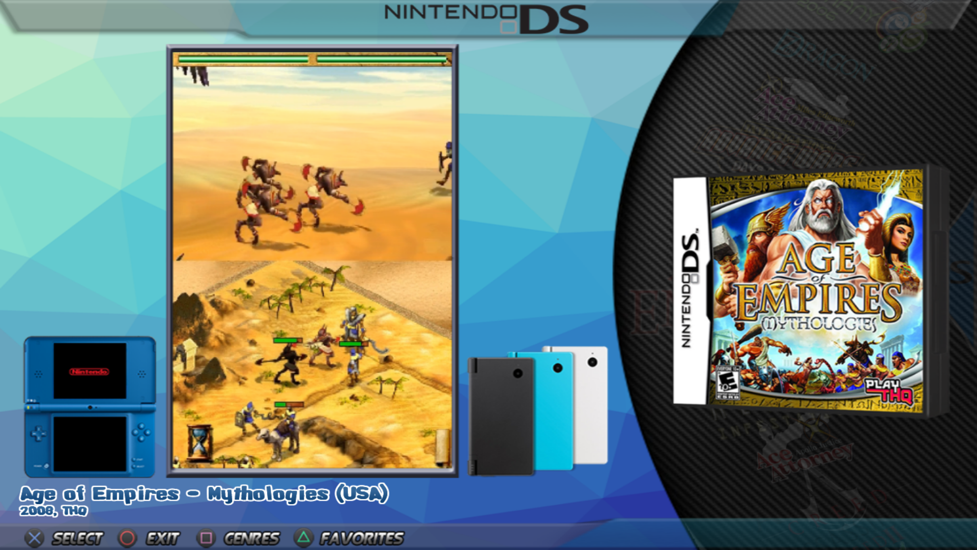

I'm using 2D covers for wheels for DS and PS2 systems since a lot of wheels are still missing.
Below how my setup looks like. Is there a way to improve it?
The probleme is that I can't see previous or next covers since they are hidden below the current wheel. I've tried different size without sucess.
Thanks in advance!

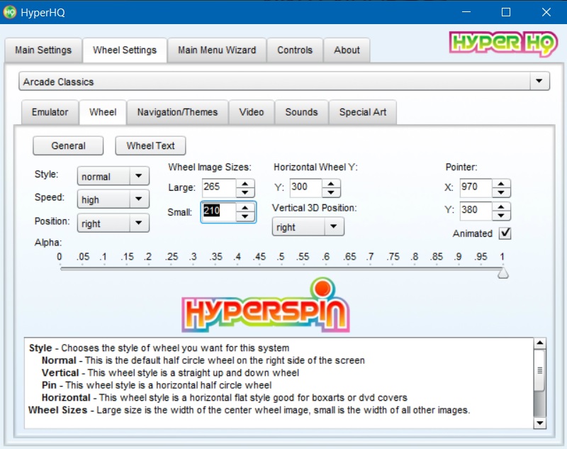

You can resize logos or any image in the wheel using HyperHQ.
Your covers are stretched in Hyperspin, you should use Fotosizer (free) and set width to 75% while maintaining height to 100%, don't forget to uncheck "keep aspect ratio"
You can batch all covers at a time with this program, just make sure you back your original ones in another folder since you may want to reuse your original covers later.

Something I've found also is you can resize all you like, but if there is no transparent space around the image it will still enlarge to the same size.
So if you want a wheel even smaller, use a program like Imbatch or something to add transparent space around images.
Thanks for your answers.
My covers have a size of 400x360, I've tried many size but I cant get something as nice as normal wheel.
Should I resize my wheels ?
