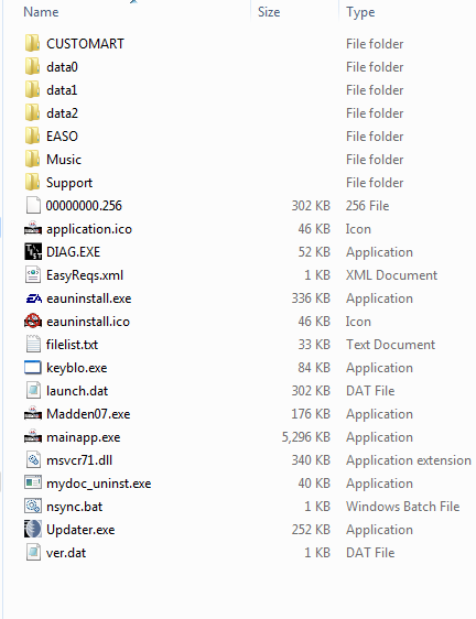

Now some games just place a shortcut to the launcher on your desktop or whatever but there may be an actual game exe in the folder (just make sure to run the launcher at least once to make some settings). Here is an example:
The installer makes all shortcuts to the Madden07.exe (which is the launcher) but after making my initial selections with it, I can run mainapp.exe directly.
Some games simply won't give you this option. Only 1 exe and it leads to a launcher! In these cases I think your best solution is to try and automate the selection using AHK. This will need to be done for each game. I am not very good with ahk myself but there may be some examples in the "PC Launcher" module folder in RL.
