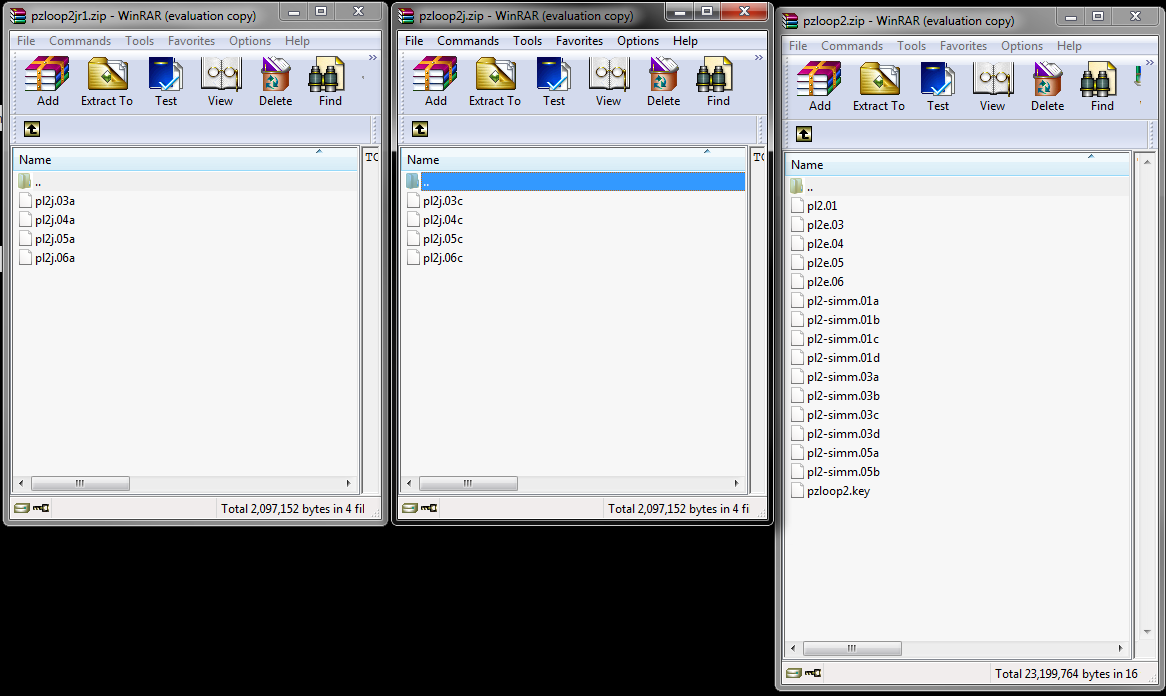

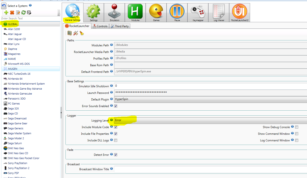

Spawk Posted November 2, 2018 Posted November 2, 2018 Are you working with a full romset? split? pzloop2j is a clone of pzloop2, it is in the directory too? And the bios of course? Does it run in mame standalone outside of RL? Beyond that you probably have to set the RL log to "troubleshooting" to be of any real use: * just remember to turn it back after you get the log as it can slow down performance when on.

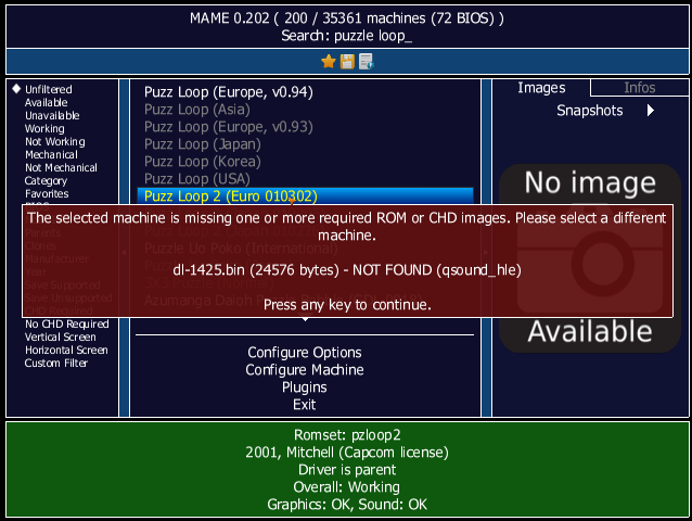

Sefirosu789 Posted November 2, 2018 Author Posted November 2, 2018 13 hours ago, Spawk said: Are you working with a full romset? split? pzloop2j is a clone of pzloop2, it is in the directory too? And the bios of course? Does it run in mame standalone outside of RL? Beyond that you probably have to set the RL log to "troubleshooting" to be of any real use: * just remember to turn it back after you get the log as it can slow down performance when on. Hi Spawk, firstly thank you for the reply. I am using the MAME 0.185 romset (split), I did not get any CHD's but it seems this game shouldn't need them? Yes, here are the 3 "pzloop2" files in my roms folder: I'm not sure what the name of the BIOS zip is, although in this next picture you can see it says I have 72 BIOS'. It does not run in standalone MAME(GM) outside of RL. So that must mean it is a problem with the files, correct? Here is what it says when I try to boot it through GM: And here is the log you requested: (sorry for length). I selected "Logging Level" to "Troubleshooting". Hope this is correct... removed because scrolling
Spawk Posted November 2, 2018 Posted November 2, 2018 The file you need is in qsound.zip There have been changes in Mame to this file lately. The file inside used to be called qsound.bin, now is named dl-1425.bin Errors like these only usually happen when you mix and match versions (using mame .201 with an .185 romset for instance). I not too familiar with groovymame but make sure you match the versions up.
