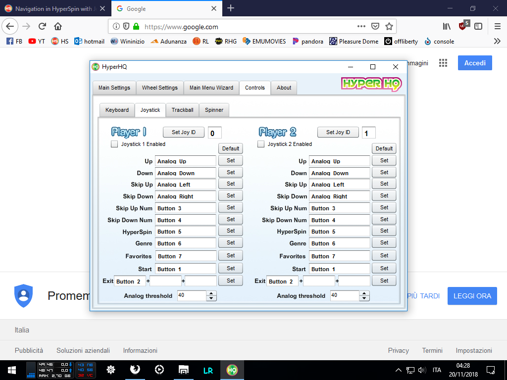

dark13 Posted November 20, 2018 Posted November 20, 2018 open HyperHQ.exe and set your joypad ... But trust me, it would be better to set up xpadder as joystick input might be terrible. Automatizing infopanels creation from .csv files for HTPCs themes (look at infopanel tutorial.zip on the ftp in dark13 folder) PNGs to SWFs automatized flash scripts Hyperspin Wheelset automatized template (photoshop's variables + batch) Aeon nox 4.13 W.I.P. hyperspin skin
Spawk Posted November 20, 2018 Posted November 20, 2018 AFAIK the Paradise Lono is not like an ipac. It is usb and recognized as joypads in windows so any tutorial for xbox/mad katz pads will be just fine for you. I concur with dark13, a keymapper will likely become a necessity. You can try the HS joystick settings but if you find them going crazy while in the wheel, you'll know this is what causes it. Keymappers will cure that from happening and also have other benefits as well like being able to set up pc games that only have keyboard support. Personally I use JoyToKey, I wrote an ultra quick setup guide in this post:
