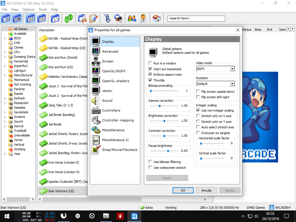

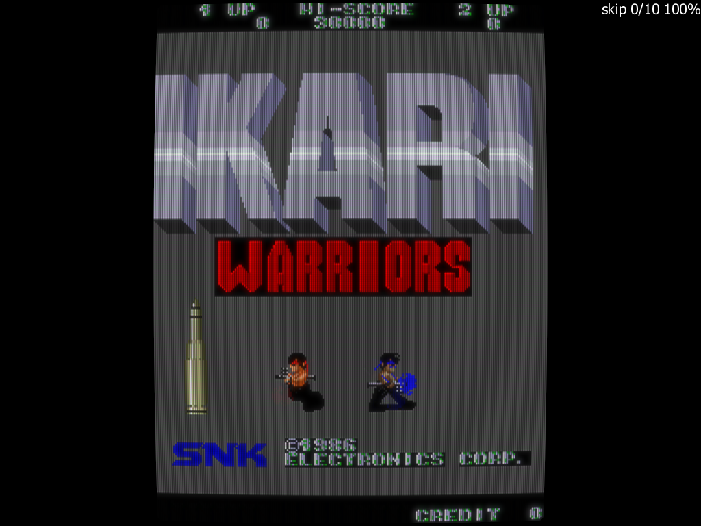

I think you actually have to activate shaders, the photo seems a no-shaders no-bilinear filtering screenshot. Set the videomode to bgfx and select ctr geom deluxe chain, it is a light shader for a decent videocard and is a nice crt emulation
And I don't like the look of the scanlines like your photo has. I just want to turn all of those settings off and make it look more smooth and rounded corners on everything and not blocky looking. How would I do that?
Well, it depends on MAME version, open the GUI, then
option->default game option->display->video mode   select BGFX
option->default game option->OpenGL/BGFX->BGFX chain->BGFX screen chain->select chain  HQX, HQ3X
