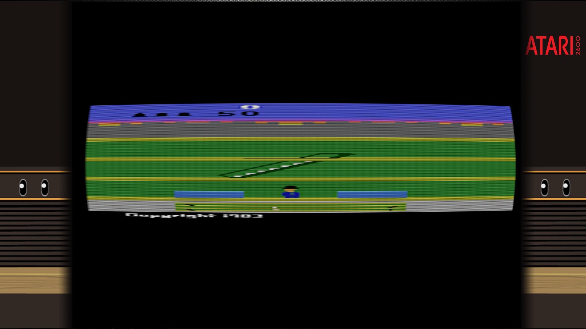

juicelee Posted February 5, 2019 Posted February 5, 2019 hi guys i am having a problem with retroarch after updating it ,the problem is this,(see below) just updaed to version 1.7.6 and my screen looking like this, is there a way to change resolution, i had it set on 1080p before update, thanks, i am updating hyperspin after 4 years so anything changed or if there are better shaders to use, i had crt curvture i think, what is the best shader to use ,or it do it depend on console.
Creezz67 Posted February 6, 2019 Posted February 6, 2019 check your retroarch module in rocketlauncher and change resolution there to either core provided or 4:3 there

Creezz67 Posted February 7, 2019 Posted February 7, 2019 Go to Atari 2600 in RL, then modules tab , then Edit Global Module Settings, Atari 2600 and where its says "AspectRatioIndex", set that to core provided, or if not working then try 16:9 as it looks like a widescreen bezel. Also set "IntegerScale" to false.
juicelee Posted February 7, 2019 Author Posted February 7, 2019 thanks mate, that sorted the problem right out, totally forgot about editing global settings, can i ask what shaders you use for your systems,thanks for your time
