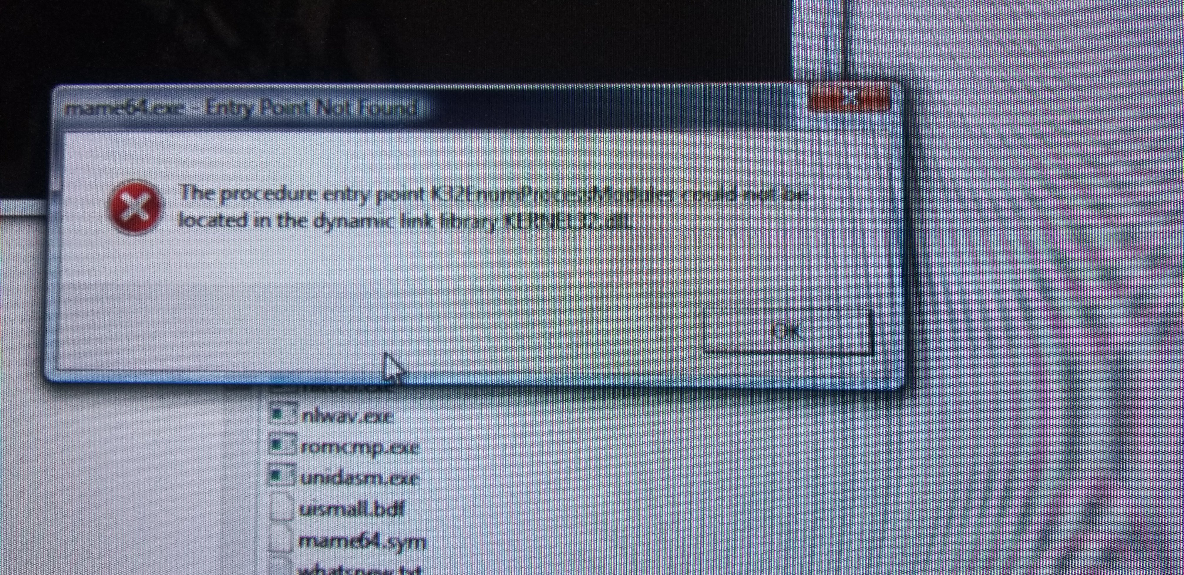

Visitor Q Posted February 18, 2019 Posted February 18, 2019 I am using Vista64 bit and it seems like any version of Mame after 0.196 I am getting this error, see attached photo. Is anyone else having this problem with Vista 64 and Mame? It is the only time I am getting this error. Thx

Creezz67 Posted February 19, 2019 Posted February 19, 2019 https://www.dll-files.com/kernel32.dll.html
Visitor Q Posted February 19, 2019 Author Posted February 19, 2019 54 minutes ago, cataclysm67 said: use windows 10 That video on YouTube I saw, it has a lot of thumbs down and no comments so I was leery about it. For the record I have the kernel32.dll file in my system folder, I guess I could try to overwrite it in safe mode with another version of it.
Visitor Q Posted March 26, 2019 Author Posted March 26, 2019 None of these solutions fixed the problem, I upgraded to Win 7 and that did. I can only assume at this point that any version of Mame after 0.196 IS NOT compatible with Vista.
