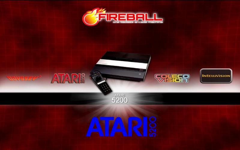

cbredgrave Posted June 5, 2014 Posted June 5, 2014 Sup folks Been working on a special main menu theme which is supposed to use a horizontal wheel. I need the selected item not to be large, but to be very very small, basically to obfuscate it behind a theme graphic. However, I stumbled on a very strange behavior, which I believe to be a glitch. Whenever my selected "large" wheel item is set below 80px (from HyperHQ / Wheel Settings / Main Menu / Wheels) , if I hold it and scroll the wheel for a couple seconds, randomly, one of the wheel item will enlarge abnormally and fill the whole screen, overlapping the entire background. If I give it another spin, it sticks there, until it hits another wheel item that glitches, then this will replace the background again. It's quite weird. Anybody else can repro that glitchy behavior? To repro: Set LARGE wheel item on a horizontal wheel to a very small number, like 1-40. Scroll the wheel a lot. Some wheel items will become abnormally large and cover some of the background. Cheers Codie
relic Posted June 5, 2014 Posted June 5, 2014 i solved his problem hes not insane all i did was change both wheel size to 150 set alpha to 0 100%
cbredgrave Posted June 5, 2014 Author Posted June 5, 2014 Relic did manage to repro the glitch, however, it's not fixed because i don't want to hide the wheel, I need it displayed without alpha, like on this shot. Technically, this theme works (Small wheel is set at 1) but if you scroll a lot for a while, all hell breaks loose. Codie
relic Posted June 5, 2014 Posted June 5, 2014 your saying you want to put consoles as the wheel but the problem is they will most likely grow bigger as well theres deffintely some kind of bug in hq 100%
