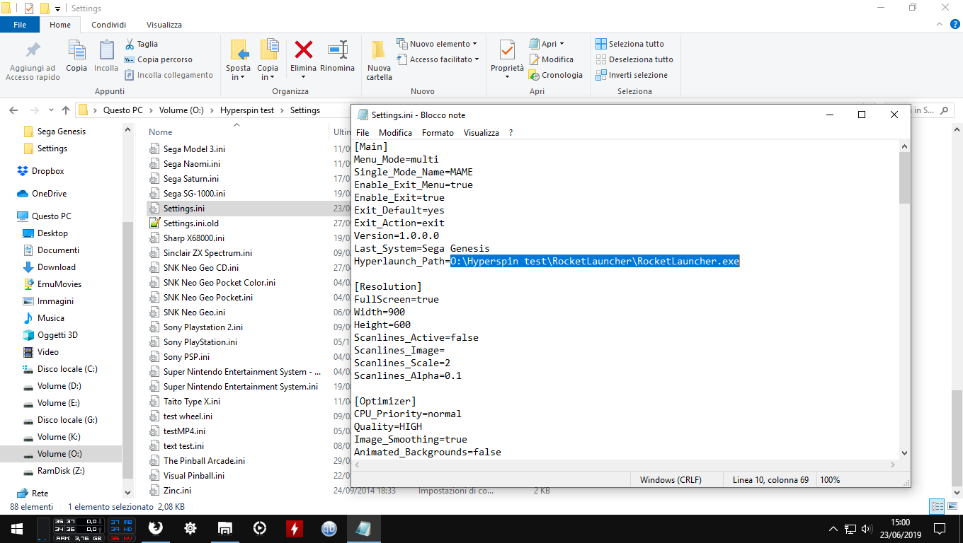

dark13 Posted June 23, 2019 Posted June 23, 2019 HyperSpin/Settings/Settings.ini put here the path of rocketlauncher or hyperlaunch. If you are using RL you must set it for HyperSpin in the options of RLgui. Automatizing infopanels creation from .csv files for HTPCs themes (look at infopanel tutorial.zip on the ftp in dark13 folder) PNGs to SWFs automatized flash scripts Hyperspin Wheelset automatized template (photoshop's variables + batch) Aeon nox 4.13 W.I.P. hyperspin skin

Spawk Posted June 25, 2019 Posted June 25, 2019 Look at the paths in those 2 pics again. In one picture you have: /arcade/rocketlauncher.exeAnd in the other you have: /arcade/rocketlauncher/rocketlauncher.exeThe second one is likely correct but physically go to that folder and see which one is correct.Sent from my SM-A520W using Tapatalk
Spawk Posted June 25, 2019 Posted June 25, 2019 The correct path is to be put in the settings.iniYou NEVER have to put an executable path in HQ. We will let RL handle the launching.The rom path and extensions are just used by HS to populate the wheel so we do include those.Sent from my SM-A520W using Tapatalk
Mbagi13 Posted June 25, 2019 Author Posted June 25, 2019 Dude, thank you so much, i updated to the 2nd path you suggested and bang, everything works 100%, you made a 40 year old very happy
