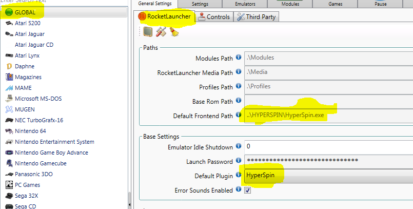

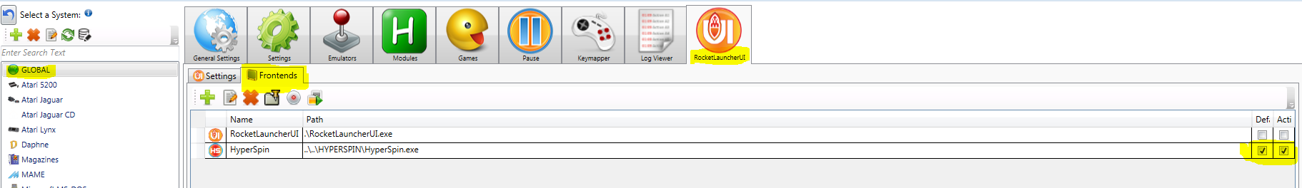

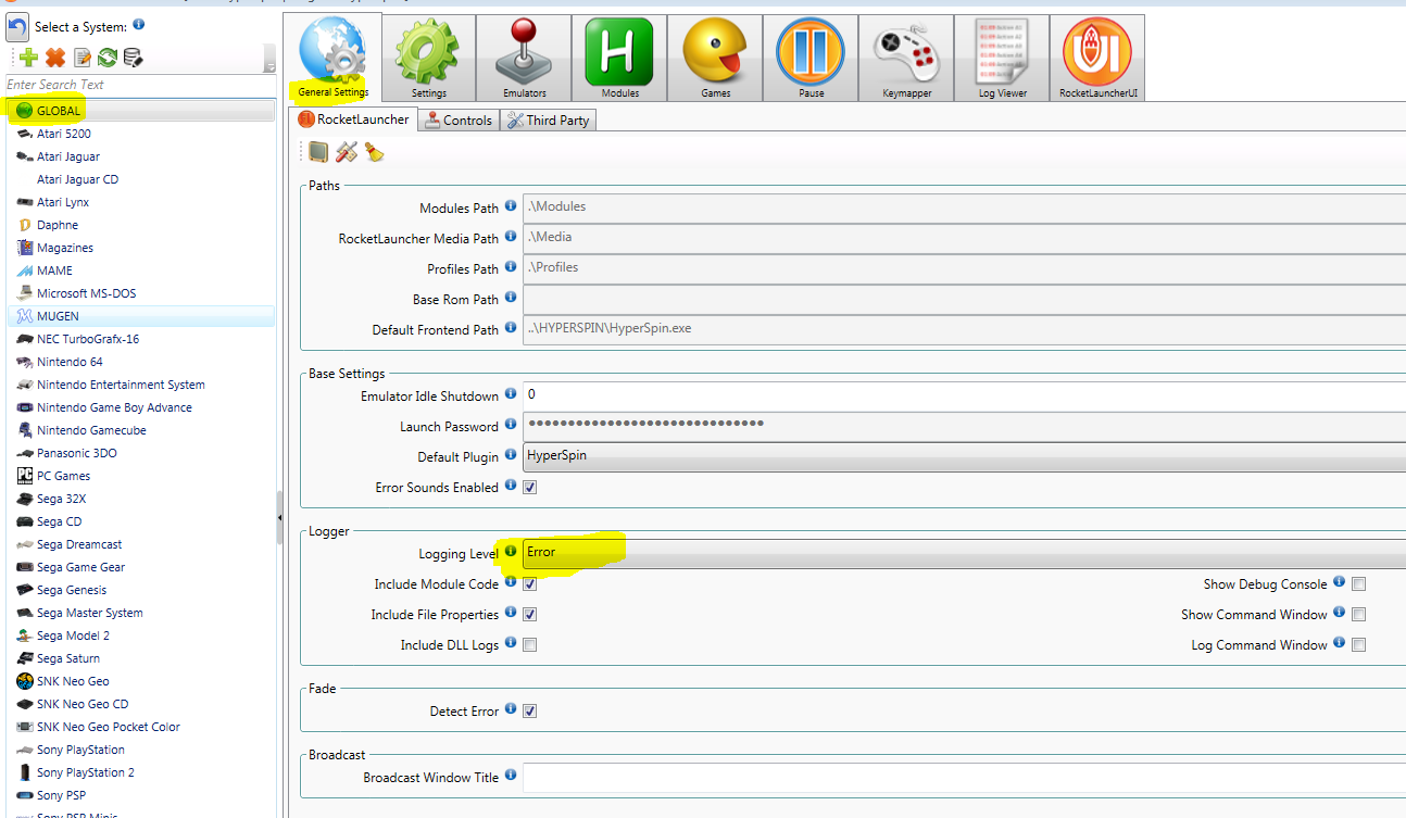

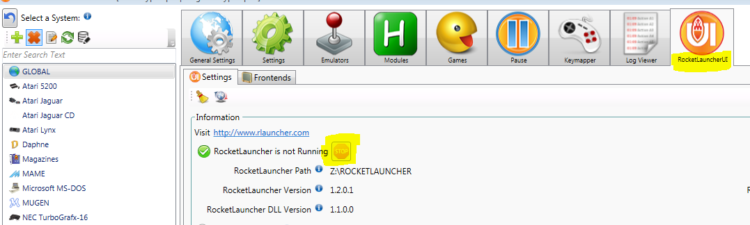

Spawk Posted September 5, 2019 Posted September 5, 2019 6 hours ago, Psicosis said: I am dealing with this same exact situation right now, except i am using hyperlaunch instead of rocketlauncher, but as you describe , its doing the same exact thing. I have figured out that the MAME.ahk file is causing it. It is In the hyperspin/modules/mame folder. There are 3 files in there. I changed the name on the one named (mame .140 BBB) to mame and now it works fine. I dont know what drawbacks are to using this other .ahk file. Hyperlaunch is old and has no options for anything. That ahk that I assume BadBoyBill (HS creator) had made is for an old mame version (we are now at .212). Maybe you are using an old romset as well? If it works for you, that's cool but it's certainly not the right way to handle the problem with RL and a more modern romset. @hooky13 you still there? I have specifically seen this behavior when the Default Plugin was set to Default or RLUI so I just wanted to cover my bases before going any further. RL must exit to be able to launch another game, this is normal.
hooky13 Posted September 5, 2019 Author Posted September 5, 2019 I switched to Windows 7 Ultimate from Windows 10 and the whole system is running smoother than before for sure. I think HS just runs better on 7. That being said I checked my settings an I do have them correct as you showed there was one that I didn’t and i did change it. The issue still persists but ONLY FOR NEO GEO games. I run with FB Alpha as my emu for NeoGeo. I can load up a neo geo game no problem but when i exit and try to load another doesn’t happen, cant load any other game on any system after the first initial neogeo game has been launched. Have to back fully out manually close out RL from status bar and restart to get it to work again. But if i select any other emulator MAME/NES/SNES/ETC I. Can run games/exit/and run more games no issues there, RL closes out like it should between each game/exit SO I can launch another. Still stumped on what is causing this. Maybe try another emu for neogeo although I have heard that FBALPHA is like the best for neogeo games. IDK.. at a loss here to figure this one out though. Let me know if you have any other ideas and i really appreciate the assistance thus far!!
