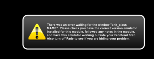

iTweeno Posted September 17, 2019 Posted September 17, 2019 MAME works perfectly outside hyperspin but its unable to open in both hyperspin and rocketlauncher. I get this error. MAME version: 0.213
Creezz67 Posted September 18, 2019 Posted September 18, 2019 Head over to Rocketlauncher forums, your module is probably outdated since MAME 0.213 emulator had a major update.
mikea213 Posted September 18, 2019 Posted September 18, 2019 If you check on this site I upload a new AHK last month that fixes this.
iTweeno Posted September 18, 2019 Author Posted September 18, 2019 On 9/18/2019 at 4:04 AM, cataclysm67 said: Head over to Rocketlaucnher forums, your module is probably outdated since MAME 0.213 emulator had a major update. Expand I found the update log but didn't find any places to download the modules.
iTweeno Posted September 18, 2019 Author Posted September 18, 2019 On 9/18/2019 at 5:28 AM, mikea213 said: If you check on this site I upload a new AHK last month that fixes this. Expand Just downloaded it , it's giving me a Invalid CRC error but it's working. Should i not bother?
mikea213 Posted September 19, 2019 Posted September 19, 2019 If its working I would ignore the crc error. I haven't seen or heard of anyone else getting a crc error but the AHK is basically a txt file
Creezz67 Posted September 19, 2019 Posted September 19, 2019 On 9/18/2019 at 4:49 PM, Officialsirwolf said: Just downloaded it , it's giving me a Invalid CRC error but it's working. Should i not bother? Expand make sure skip checks is set to "Rom Only" if using split set
iTweeno Posted September 19, 2019 Author Posted September 19, 2019 On 9/19/2019 at 5:02 AM, cataclysm67 said: make sure skip checks is set to "Rom Only" if using split set Expand Umm where can i do that?
Creezz67 Posted September 20, 2019 Posted September 20, 2019 I am assuming you are using RocketLauncher also ? If so, go to Mame, then Main settings, and look for an option called Skip Checks (set this to rom only) as you may have it set to false.
