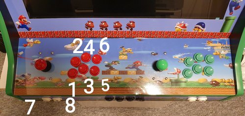

I have a two player bartop, set up with two Reyman zero delay usb encoders.
My question is: How do I wire them up correctly to use them with Hyperspin?
Right now, the buttons for player 1 and two are wired as shown in the Picture. For player 1, buttons on the front are 9, 10 and 11.
Hope you Guys can help ?

zero delay encoders is nothing but a marketing name
serial joysticks sucked and had a horrible delay -->  USB  no delay
what you have is a joystick encoder
you basically saved yourself the trouble of doing this to a USB controller
https://www.slagcoin.com/joystick/pcb_wiring.html
as you may or may not know  Hyperspin has a bug with USB controllers
DISABLE!!!!!!!!!!!!!!! usb joysticks use in HyperHQ
and use this to map your Joystick Encoder to Hyperspin.
it was built for a 360 Controller but you can change the button numbers to match what you have/want
