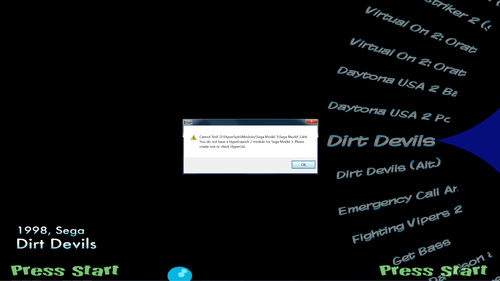

juicelee Posted January 4, 2020 Posted January 4, 2020 hi guys i am trying to set model 3 emulator up . it runs fine out of hyperspin and in rocket launcher . but i get this when i try to run it in hyperspin. the same happens for any of the arcade classics (atari classics etc) i got round the arcade classics by making a folder in the moduals called atari classics and copyed and renamed the mame modual to atari classics and it worked, but i dont think this is right. thanks guys
32assassin Posted January 5, 2020 Posted January 5, 2020 their are 3 possible things that can be wrong 1. you don't have your Hyperspin plugin set up in RL 2. you don't have the correct path to Rocketlauncher in your Settings.ini 3. you have Hyperlaunch disabled in HyperHQ 2. check your RL path C:\HyperSpin\Settings\Settings.ini make sure it matches your RL location Hyperlaunch_Path=..\RocketLauncher\Rocketlauncher.exe 3. post pictures of your HyperHQ settings you can also post your C:\HyperSpin\Log.tx after a game fails to launch
