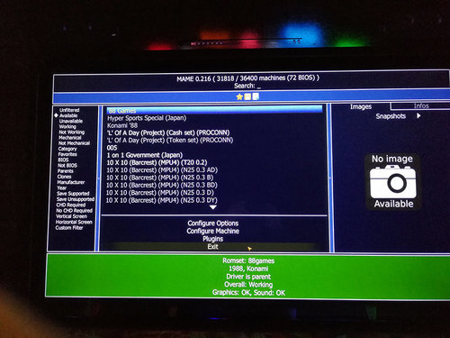

Hello,

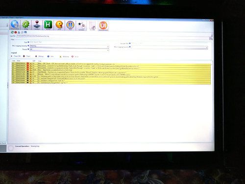

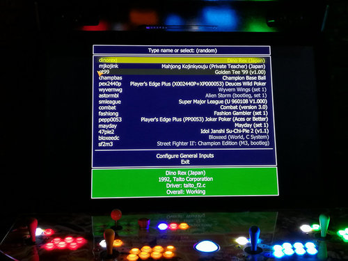

I've set everything in RL for the MAME 0.216 version but when  launch a game in Hyperspin, in place of laucnhing the game, I get this screen (see attachment 1.jpg).

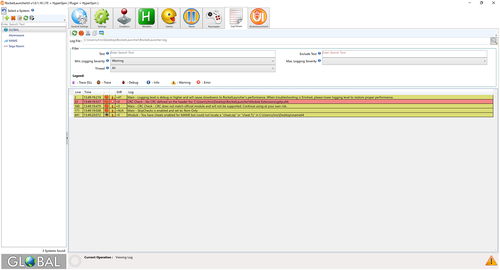

When I click on exit, I get MAME (see attachment 2.jpg) but the game is not launched.
Has anyone an idea?
Thanks and regards,

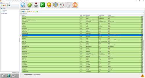

I've downloaded the 2.3.10 ahk version but it's in red with those 2 errors:
Invalid CRC,  module might have been tampered
Invalid ISD CRC, ISD file might have been tampered...

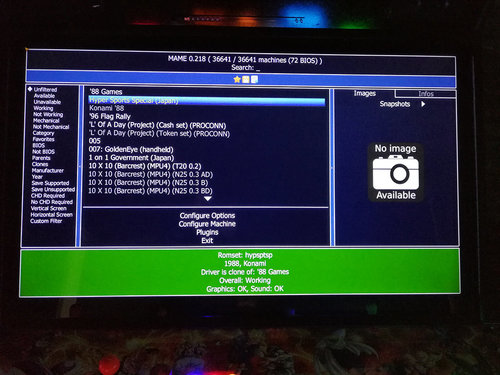

Thanks to the MAME64 0218 and module 0212 version of mikea213,  MAME seems to launch correctly now but it’s not launching the game.
By asking a log, I get this :
Think the problem is in the last 4 lines mentionning 7z. Seems to be a problem with the path or name of the roms…
 If anyone has an idea, it will be greatful.

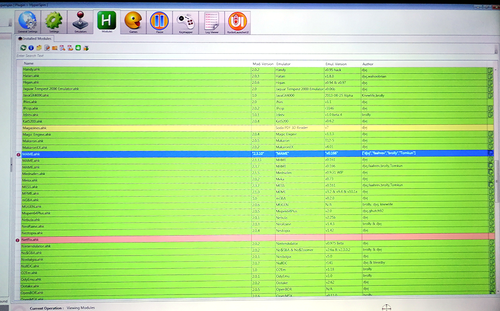

I've downloaded and installed RL on my PC and updated it.
I set the same settings, same module and same emulator that on my cab and well, games are launched.
The only difference I see is that the module is interpreted as "2.3.10" on my cab
and as 2.3.10 on my pc.
This is the warning on the log on myc pc to compare with the one of my cab but it worked.

I downloaded  version agent47 of the MAME.ahk + set the 7z files to FALSE and now the games are running
on Mame 0218 mikea213 version.
