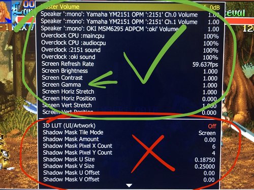

Haxorz Posted March 11, 2020 Posted March 11, 2020 I wish there was a way to save “slider options” permanently but through a research I did, everyone says it’s almost impossible. They say we have to do it for each mame game separately in each .ini, it’ll take an eternity. I tried to change: RocketlauncherUI mame HLSL: true or ini..nothing HyperHQ mame video scanlines activated...nothing Change mame.ini scanlines amount...nothing All of the above together simultaneously...nothing Hyperspin seems to “ignore” any change and open mame games with default video options. Funny enough, (as you can see to the image I attached), the upper half of slider options is always saved when changed (such as “screen gamma”), but the second half of slider options (the one with scanline option), under the line, under 3D LUT, never saves...always goes back to default every time we open a game, NO MATTER what I did. Is there a way to at least activate Bilinear Filter to all mame at once permanently, so they won’t be pixelated every time we open them? Thanks
dark13 Posted March 11, 2020 Posted March 11, 2020 Move Arcade64.exe (download section) in MAME folder and start it configuring mame from the there. As far as i remember arcade64 can save slider value (maybe some plugin), not sure if it works in GLSL. Anyway it is better to use BGFX shaders, you can manually configure them from json files. BGFX by default run under vulkan and you get a better input lag with vsync turned on compared to GLSL. As usual to test input lag just use "battle garegga". Automatizing infopanels creation from .csv files for HTPCs themes (look at infopanel tutorial.zip on the ftp in dark13 folder) PNGs to SWFs automatized flash scripts Hyperspin Wheelset automatized template (photoshop's variables + batch) Aeon nox 4.13 W.I.P. hyperspin skin
dejarik Posted March 11, 2020 Posted March 11, 2020 I'm no MAME expert but Have you try editing the MAME\ini\presets\mame.ini ? # BGFX POST-PROCESSING OPTIONS # bgfx_path bgfx bgfx_backend auto bgfx_debug 0 bgfx_screen_chains crt-geom bgfx_shadow_mask shadow-mask.png bgfx_avi_name auto once you write the shader you want for me it's crt-geom just make sure you point rocketlauncher (IniPath) to the MAME\ini\presets\ directory

Haxorz Posted March 11, 2020 Author Posted March 11, 2020 Hi dejaric, and thanks for your help, but I already tried to change mame.ini and even if I save, Hyperspin still runs mame raw ignoring the mame.ini changes ONLY when it comes to the 2nd half of slider options (as I mentioned in the image I attached above). Is there any other way. Has anyone configured Hyperspin mame to permanently open WITH shaders?

dejarik Posted March 11, 2020 Posted March 11, 2020 No don't uninstall directx you actually don't need to uninstall anything but tweak MAME settings I think i personally was using d3d but like dark13 mention maybe vulcan is better for input lag , you need to test and make a choice. mame.ini and pointing rockectlauncher to the right folder was the way i was able to make the shader setting stick, tweaking the slider directly in MAME option didn't work for me.

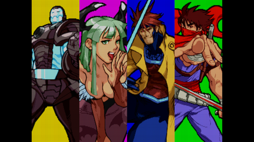

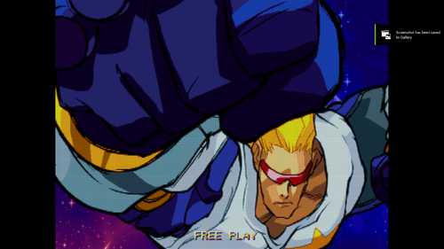

pacifikballa Posted June 8, 2020 Posted June 8, 2020 I use BGFX only. I feel that is has the best scanlines IMO, this is subjective though. I modified two .json files, one for fighter and the other for shmups (shooters). I don't have any lag or slowdown...I use MAMEUIFX 0.175 Here are a couple captures I took of Marvel vs. Capcom (native res is 4K/best viewed full-screen):
