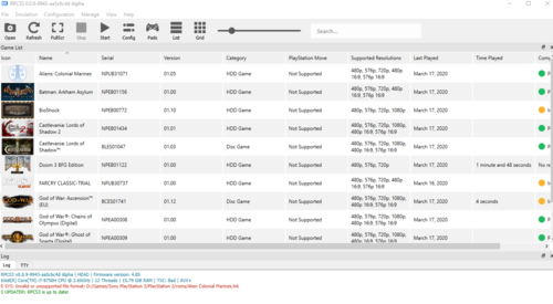

razobark Posted March 19, 2020 Posted March 19, 2020 Hello everyone I open this thread in case you can help me with rpcs3 in your latest build 0.09 and hyperspin. The emulsifier has changed the way I load games and now it doesn't support the shortcuts created to run the roms. Before I loaded the games with the rpcs3 module, I have created bin shortcuts with the name of the games but when updating the emulator to its latest version now gives me error.
Creezz67 Posted March 19, 2020 Posted March 19, 2020 3 hours ago, razobark said: Hello everyone I open this thread in case you can help me with rpcs3 in your latest build 0.09 and hyperspin. The emulsifier has changed the way I load games and now it doesn't support the shortcuts created to run the roms. Before I loaded the games with the rpcs3 module, I have created bin shortcuts with the name of the games but when updating the emulator to its latest version now gives me error. Just checked this on latest RPCS3 Alpha build and it loads fine with txt or lnk shortcuts. Check that you have the latest module, also set skip checks to rom only.
shitoken Posted March 24, 2020 Posted March 24, 2020 I am also using lnk shortcuts with latest update and it load fine. Only issue is exiting by ESC it never exit emulator
razobark Posted March 30, 2020 Author Posted March 30, 2020 thank you all for the help, updated the module and it works well.
