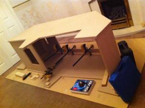

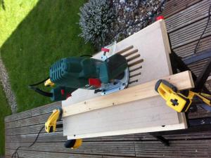

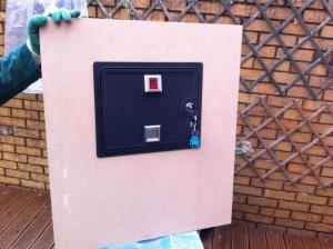

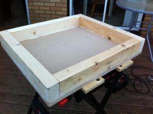

Sorry for the slow reply here, I have been busy with lots of things including the arcade cabinet. There is an update for the blog due shortly (as the cabinet is nearly ready to stand up) but I will post a selection of pictures from the blog in here.
In answer to your questions Monkey, the PC setup is already done although it is constantly evolving as I work in IT I usually collect things along the way which might be useful to me. I will write up the current specs in the next post I make here, it's nothing special but does the job although I need a graphics card as I recently installed Street Fighter 4 and get 15 fps :(
I haven't decided on any of the artwork or marquee stuff yet although my idea was to have full side art with Bub and Bob on either side at the bottom blowing bubbles with various famous/favourite characters (not only from Bubble Bobble) trapped in bubbles up the side of the cabinet. What do you think?

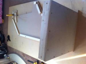

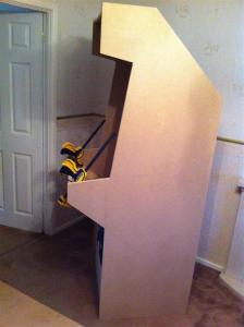

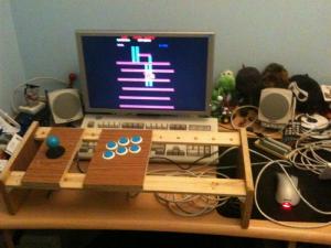

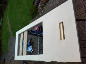

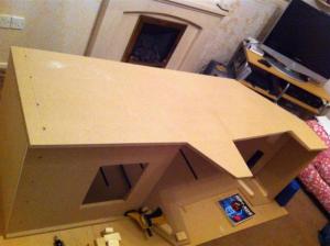

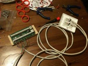

Here are some pictures for now. Hopefully they will start to get more exciting soon. There is a bit of everything here from the prototype control panel made from bits of kitchen cupboard, the wiring to the network sockets and the assembly of the base and cabinet.

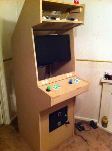

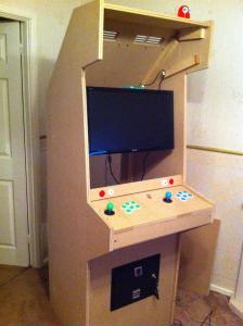

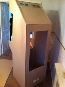

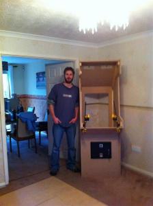

Here are some pictures of the cabinet actually stood up. I also have lots of pictures and more blog updates to write regarding the modular control panel and my attempt at implementing light guns. I have finally ordered a monitor so it should be up and running soon so that will be the end of build progress once I can play Donkey Kong.

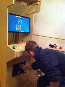

Making some progress now :)

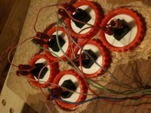

I have 2 x 8 way joystick panels fitted and 2 x 6 button panels fitted with a spacer in the middle. This will be the default panel layout as it fits in with the Bubble Bobble theme and will cover most games you can play. When it stops raining I need to cut a wider panel for the Start buttons and the red buttons on there will be replaced with white ones.
The red buttons will then be used in another button panel to go with a red ball top 4 way joystick.
I have an Aim Trak gun working which I have put in a Gun Con casing but it's a work in progress as I am hoping to get the recoil feature wired up. I have loads to do but need to stop myself from playing on there now so I can actually finish it. Here are a few pictures but there will be more pictures and details on the blog http://bubbob.retro.me.uk/ when I update it.
I have a huge list of things to do but keep playing Virtua Cop 2, Bank Panic, Bubble Bobble and Donkey Kong.

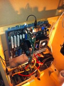

Here are some more pictures. They should all be on the blog if you have been reading that.
Internal stuff - motherboard, amp and power strip.

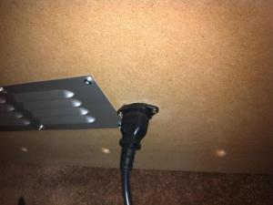

Power cable wiring and power cable connection on the back. I only have the one power cable connecting the cabinet to the wall socket and the motherboard is set to auto power on when the mains plug is switched on.

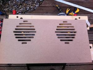

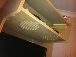

Speaker grill and speakers
Hopefully the pictures aren't too big. Let me know what you think.
