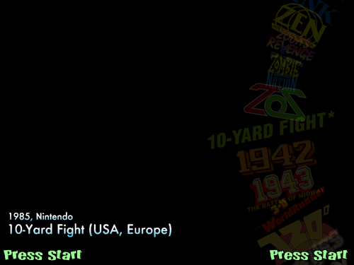

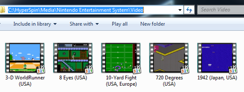

Thank you for the support! I've attached 2 images. The first is my directory with the NES videos, one of them being "10 yard fight". Next image is what it appears on my hyperspin wheel for NES when that particular game is highlighted, I would expect the video to play but there is no action occuring.
I'm curious if it may have something to do with there not being a "theme" for all the games. The only videos that play in the NES wheel are those that have an accompanying theme in the theme folder for NES.
So for this example, there is no theme for "10 yard fight" and thus no video is played.
For games that do not have a specialized theme created for them from HyperSync/EmuMovies, is there a default theme you can set as a "catch all" for all remaining games?

I figured it out. I needed a default theme (note it has to be labeled "Default" in the NES system theme folder). So whenever there is not a custom theme present for a selected game, it will use the default and thus provide a place where the video snap to pay. Hope this can maybe help someone else in the future, thanks again!
