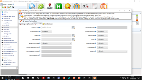

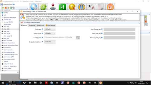

dark13 Posted June 19, 2020 Posted June 19, 2020 Atari 800 emulator must be set to "5200" in option You need to set RA config folder Check also that the correct core is selected You need also "5200.rom" in RetroArch/system (bios) Automatizing infopanels creation from .csv files for HTPCs themes (look at infopanel tutorial.zip on the ftp in dark13 folder) PNGs to SWFs automatized flash scripts Hyperspin Wheelset automatized template (photoshop's variables + batch) Aeon nox 4.13 W.I.P. hyperspin skin

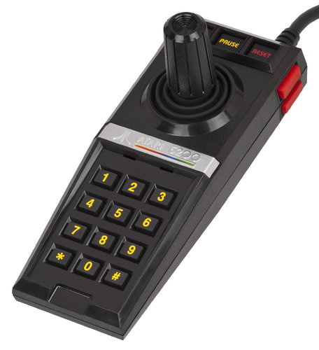

Spawk Posted June 21, 2020 Posted June 21, 2020 3 hours ago, justbbuck said: Now I have to figure out the controls to make everything the same.... This might prove difficult... at least for the Atari 5200, here is the controller: https://www.google.ca/url?sa=i&url=http%3A%2F%2Fwww.atarimuseum.com%2Fvideogames%2Fconsoles%2F5200%2F5200paddle.html&psig=AOvVaw1OJHV9NZnKvpZ6W4L05BoI&ust=1592803340758000&source=images&cd=vfe&ved=0CAIQjRxqFwoTCLjvxfyUkuoCFQAAAAAdAAAAABAR This is the paddle version, there is also a joystick version. Mapping either to a gamepad like xbox360 (what I am using) is practically impossible. I suppose an arcade panel set up specifically for this could be feasible... but it's a lot of buttons!
Spawk Posted June 21, 2020 Posted June 21, 2020 Here's a better look at the joystick version: Those red buttons are on both sides. So 12 for the numpad, 4 for shoulder buttons, and 3 system ones along the top. So 19 buttons... for each player. To further complicate things games included an "info" card that would slip over the numpad to tell you what buttons did what. I am sure there are a great number of games that are still playable with very few buttons used but you may have to take this system on a game to game basis. I would like to hear peoples experience with this system.
