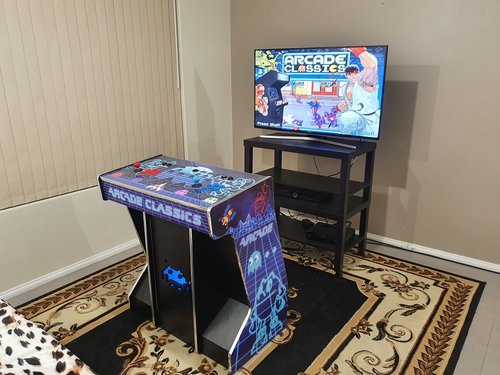

hippyd Posted November 28, 2020 Posted November 28, 2020 Does anyone have Pinball FX3 on their Hyperspin? I have a pedestal style machine connected to a tv via HDMI. Tried to play Pinball FX3 and the buttons don't work. Plugged in a keyboard and can now use the flippers using the shift keys. Is there any way to play this without the keyboard? Another thing, I've noticed with this and another pinball game that there is a fraction of a second delay when hitting the flippers, which makes it hard to time hitting the ball properly. Is this an issue with all Pinball games on hyperspin or is it just my machine?

hippyd Posted November 29, 2020 Author Posted November 29, 2020 My GPU handles everything well. I actually have a couple xbox controllers that came with this but pinball isn't something I'd want to play with a controller, rather stand up hitting the buttons like a regular pinball machine. I'm in contact with the guy who made the machine so I'll do some more troubleshooting.
