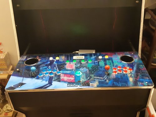

Hi everyone,
Doing my first ever cabinet and its great to be part of the community.
I'm up to learning about Hyperspin and Rocketlauncher and watching the tutorial videos, but I can see that Rocketlauncher hasn't been updated since 2015. Also the intro videos here are from 2016, before it seems it was clear that Rocketlauncher stopped development, so before I go down this path I just want to make sure that Hyperspin and Rocketlauncher is still the best practice.
I'll be running on a 40" widescreen TV on a Viewlix style cabinet. Computer Specs:
Core i5 (10th Gen)
16GB DDR Ram
Geforce 1650 GTX
500GB SSD (plan to add more)
If relevant, Control panel is 22 button config with Trackball (see pics). Also has coin door
System will be mainly used for retro games but will install some selected newer ones
Thanks in advance :)

Nice looking cab you got there! RL is most definitely needed. Don't let the lack of updates deter you. The only thing that ever needs updating is the modules when emulators decide to change things. These are usually easily found on the RL forums. It still does way more than any FE could dream of doing. I don't see how anyone could avoid using it no matter what FE they are running. And as far as HS, what is the alternative? Go back to Hyperlaunch? It died the day RL started... load through HQ? hahaha, it's laughable.

The cabinet looks awesome dude! I recently built my first cabin with my dad, it's 4 player and looks pretty cool but I just have no idea how to design the decals. I'm decent with photo editing but the weird shapes that the decals have to be just makes my head spin. Anyways, as a fellow noob, I can say, the Hyperspin+RL combo has not let me down. My main problems have come with emulators. Just a tip, try to use multi system emulators if possible. Mednafen being a good example, it can be a bit hard to set up but it runs many systems and will save you time. If you need a good guide on that, let me know.

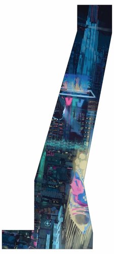

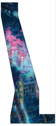

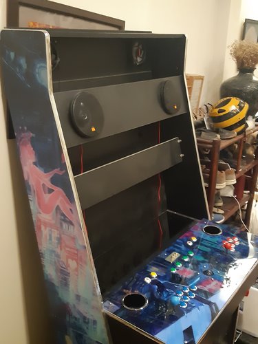

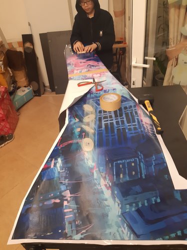

@SparklePig78 for the decals, I had the initial cabinet designs which formed the basic shape for the designer to work from.
The cabinet panels were all CNC milled so I took secondary measurements including angles to see what the actual dimensions were.
The artwork is commissioned from a local artist here in Hanoi from a VN Cyberpunk series. As part of me paying for re-use rights they resized all the artwork onto the cabinet files.
When we printed it, the directive to the decal guys was to scale the print so that it was at least 1cm beyond any edge. It works in this scenario because the artwork is continuous. It would have been muh harder if the artwork was meant to follow the lines of the cab.
When the decal was laid down, it was brought over edge and trimmed to the edge of the t-moulding groove. That way you get a nice continuous uninterrupted decal that goes over edge and disappears behind the t-moulding, and you can be forgiving about discrepancies between design file proportion and actuals with print scaling.
Fun fact, you can do 3d decal printing where the decal is actually physically textured based on the color palette
