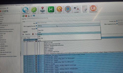

maliusmaximus Posted December 24, 2020 Author Posted December 24, 2020 5 minutes ago, Spawk said: Set to troubleshooting not debug. Then upload the rocketlauncher.txt in the root folder of RL. I am away from home atm so I will not download anything to my phone. Must be a link. Sent from my iPhone using Tapatalk @Spawk no option for troubleshoot that I can see. pls see screenshot
