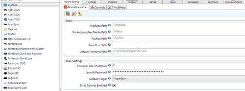

Thanks for the link Spawk,
Default Plugin was set to RocketLauncher, followed the yellow highlight and changed it to HyperSpin.
Rest looks identical far as I can see...

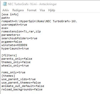

(There is a "NEC TurboGrafx-16.ini" in X:\HyperSpin\Settings folder)
I still have the same error message;
Cannot find "# # # OrginalAktuell_NEC TurboGrafx-16.ini"
(I made a .xml database file with that name using "Don's HyperSpin Tools", but I cannot for my life figure out how that titled .xml name ended up as an error missing .ini ?!?)

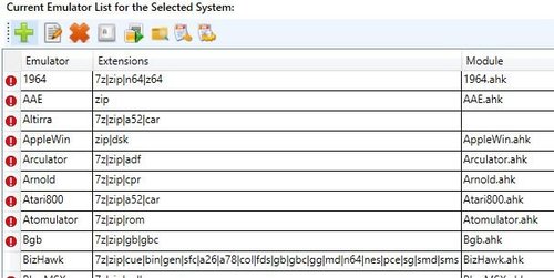

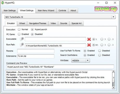

Screendumps below of my settings, pherhaps I am missing something obvious? Do you see anything below thats off?
I have tried toggling "roms only" on/off, nothing changes with that one. (Thanks for confirming thats a possible error source)
Not setting extensions/ex, what precisely does this entail?
I noobily thought it meant not set Executable, speaking of which I run BizHawk 2.6 recommended by ytube for NEC TurboGrafx-16, however in the Emu folder there is no BizHawk.se but instead EmuHawk.exe & DiscoHawk.exe
(All other Emulators has an .exe named after the emulator in Q pretty upstraight with the exception of a sparsely "x64" addendum.)

Never set the "Executable" path in HQ for anything ever. We simply point to RL and it does all launching. If you had a path in here at one point, you may want to open "NEC Turbografx-16.ini" in a text editor and make sure it isn't there... even though you may have deleted it in the HQ UI just to be sure. Only reason to put anything in these HQ spots is because you want to use the "roms only" filter. Otherwise everything can be left blank. Sounds like you are looking for 100% green audit so... you are not really filtering anything anyway. All the real rompaths are set in RLUI.
What emulator you use might be kind of irrelevant until you sort the above out. You do want to load these games up in the emulators themselves outside of RL/HS first to make sure everything does in fact work. I have no idea what EmuHawk or DiscoHawk are, I don't see modules for them but you can set the path to BizHawk (and all other emulators) here:

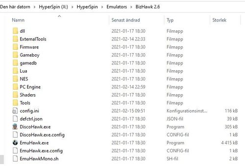

Confused Noob: - Yep, I set the paths for respective emulators in this tab (Yours above, mine below)
Confused Noob: - Also the EmuHawk.exe in the BizHawk emulator folder is this stuff,
1440124439_HyperSpinEmulatorsBizHawk2.6EmuHawk_exe.thumb.jpg.769b960fe887e3ce26b221d460faff14.jpg

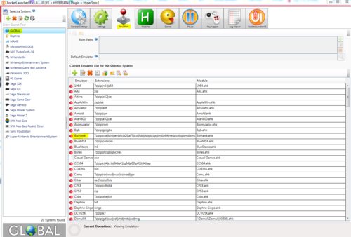

This might be part of your problem. I tried to mention it earlier, but once you connect HS and RL properly, it reads all databases from the HS folder structure.
I am going to PM you.
Oh you think thats where I messed up? I actually did this due to watching ytube tutorials and one guy underlined it was important to have everything running in RocketLauncher before you even started thinking of messing with HQ if you wanted everything running properly. Guess that was off then? I look forward to your PM Spawk, I am curious if theres any rescuing this mess 😕 I cant believe your patience mate but I appreciate it!
You do want games running through RL before expecting them to run in HS but the very first thing you should do is connect HS/RL including setting the “default plugin” to Hyperspin. You had it on RLUI which reads databases from it’s own folder structure. Technically this is fine, there is often more than one way to do things in these types of setups. It’s just easier to set it to the proper plugin and use HS databases and be able to add systems right in HQ.
