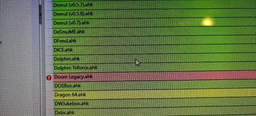

Tinke Posted March 25, 2021 Author Posted March 25, 2021 I have Windows 10 home and hyperspin need virtual hard drives? Dolphin run others consoles like Dreamcast but Wii not Work because dll missing file. DirectX 11 maybe. I dont remember. I check after Work.

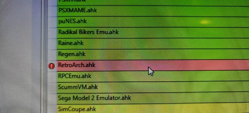

Tinke Posted March 25, 2021 Author Posted March 25, 2021 Nono. Problems is missing dll files and retroarch. IS red on hyper Launcher. Wii and few other not working ( missing dll) Mame and pc games working nice. All consoles what use retroarch not working. I read internet that vcruntime140.dll is cyberlink media file? Is Deamon tools lite virtual drive necessary? Hyperspin dont work whitout them?

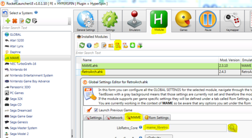

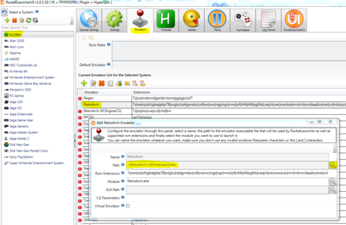

Spawk Posted March 25, 2021 Posted March 25, 2021 Use the little magnifying glass to set the location of RA.exe Then for each system that uses RA, you must specify what core to use in the "Global module settings": Nobody really uses Dtools anymore I don't think. Most emulators run images directly nowadays.

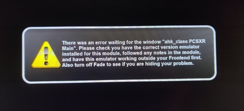

Tinke Posted March 26, 2021 Author Posted March 26, 2021 What i do? Some ps1 games run fine and other not run and all game is green RA.
adamg Posted March 26, 2021 Posted March 26, 2021 Can you run PCSXR outside of Rocketlauncher? Can you post the Global settings for the emulator from rocketlauncherUI?
