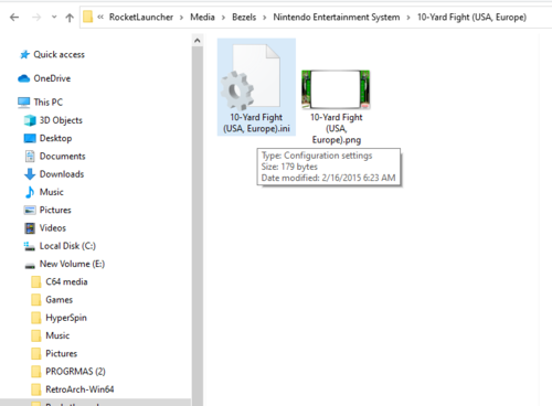

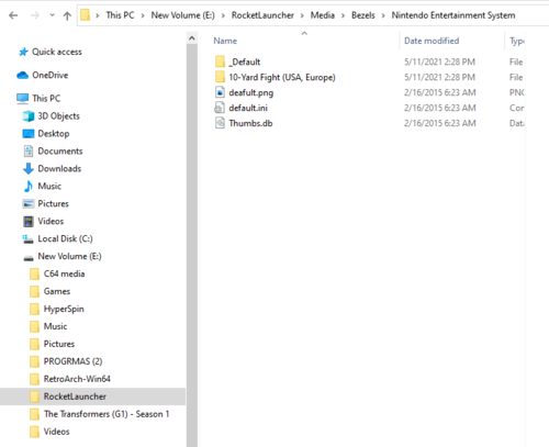

megananthony Posted May 11, 2021 Posted May 11, 2021 Hello Everyone, Thank you for taking the time to read this. So, been working on setting up hyperspin over the past few weeks, It really is pretty intense. I am progressing pretty good but i have hit a roadblock. I can seems to get any bezels to load. Default per console or individualized. For now, I'm just focusing on one bezel (just to understand the methodology), 10 yard fight for NES. So far, i have the settings in RLUI as follows -Global- settings-Bezel- enabled set to True - Fullscreen bezel set to fill, use backgrounds set to true In hyperspin folder directory, i have hype hyperspin-media-bezels-Nintendo Entertainment system (same naming as global console in RLUI) , inside the NES bezels folder, i have a default.png image, default.ini . I also have a _Default folder and folder specific for the 10 yard fight bezel named 10-Yard Fight (USA, Europe) (the .png bezel inside the folder also has the same name) default bezel doesn't load, 10 yard fight bezel doesn't load either I am using Retroarch as emulator - i don't see anything under modules that i would need to configure Any thoughts ? Thank you in advance
Spawk Posted May 11, 2021 Posted May 11, 2021 If you are using RL bezels then they go in the RL folder structure not the HS folder:
megananthony Posted May 11, 2021 Author Posted May 11, 2021 ok, i tried that and still no bezel displayed

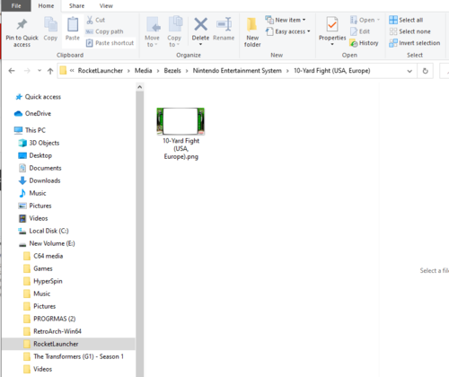

Spawk Posted May 11, 2021 Posted May 11, 2021 10 yard fight has a png but no iniAlso you do not need default png and ini in the NES folder. Only inside the “_Default” folder.Sent from my iPhone using Tapatalk
megananthony Posted May 11, 2021 Author Posted May 11, 2021 I tried that and still no luck (also removed the deafult png and ini from the NES folder, and confirmed they were in the _default folder as well

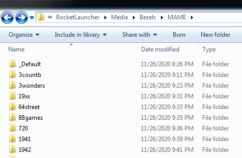

griffin518 Posted May 14, 2021 Posted May 14, 2021 This will sound like a really basic question... but are you sure the RL media folder you have is named EXACTLY the same as you've defined the system in RL? You are correct about "I know if it wont work in RLUI, it probabl is the same reason it wont work in HS" - they are two different applications, joined at the hip for a single user experience. HS is literally just the graphical front end. After you hit your "start" button, everything you see until returning to the graphical wheel is handled by RL. Download my RocketLauncher bezels: http://hyperspin-fe.com/files/file/14367-griffin518s-bezel-depot/ Best of MAME HyperSpin XML: http://www.hyperspin-fe.com/files/file/11710-griffin518s-best-of-mame-xml-database/ Best of MAME bezel pack: http://www.hyperspin-fe.com/files/file/11711-griffin518s-best-of-mame-bezel-pack/ Custom MAME ini files w/HLSL settings: http://www.hyperspin-fe.com/files/file/11712-griffin518s-best-of-mame-mameuifx-ini-files/
