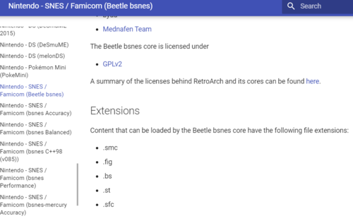

Also, specific cores (like Beetle bsnes) may not accept .zip as a valid extension:
taken from: https://docs.libretro.com/library/beetle_bsnes/
You can unzip 1 or 2 for testing purposes inside RA first, just use the "load content" and browse for the actual file.
Then you can just enable 7zip in RLUI for this system and it will uncompress the rom for you before it sends the load command to RA.
