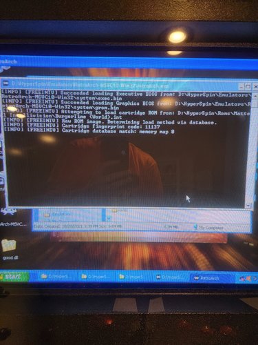

drjea2010 Posted December 31, 2021 Author Posted December 31, 2021 Here is a quick snap of the readout before the error pops up. Anything telling here? Also, I tried it on a second, different computer....this time after loading the core and then trying to load a game, it acted like it wanted to start but then RA just closed/went away. The 2 .bin files are indeed in place. No error on my second (non-gaming) machine....just closes RA down entirely.

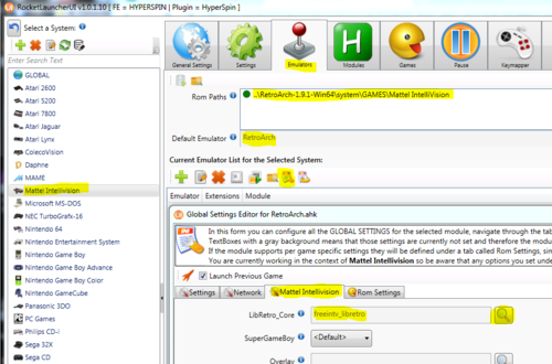

dark13 Posted December 31, 2021 Posted December 31, 2021 Try if the game works launching it directly from RA. In RLgui set the core and the config folder. I've not tested latest RA build, still on RA 1.9.6 Automatizing infopanels creation from .csv files for HTPCs themes (look at infopanel tutorial.zip on the ftp in dark13 folder) PNGs to SWFs automatized flash scripts Hyperspin Wheelset automatized template (photoshop's variables + batch) Aeon nox 4.13 W.I.P. hyperspin skin
drjea2010 Posted December 31, 2021 Author Posted December 31, 2021 I don't have a config file specific to Intellivision in the configuration folder of RA? Do I need one? How do I make/ get one? Not sure what to point to there...

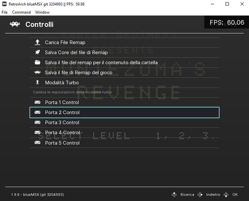

dark13 Posted January 1, 2022 Posted January 1, 2022 Yeah, intellivision core seems to miss input mapping. Maybe a RA folder dedicated to intellivision might be a good idea, just configure keys from general setting. The good thing is in RA with select you can change joystick port and RB pops up the keypad. It's a shame, Puae and Vice cores have wonderful per game input mapping option. Automatizing infopanels creation from .csv files for HTPCs themes (look at infopanel tutorial.zip on the ftp in dark13 folder) PNGs to SWFs automatized flash scripts Hyperspin Wheelset automatized template (photoshop's variables + batch) Aeon nox 4.13 W.I.P. hyperspin skin

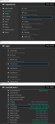

dark13 Posted January 1, 2022 Posted January 1, 2022 yeah, it is made to use the keypad, not enough buttons to map them all You can change general input mapping from here Automatizing infopanels creation from .csv files for HTPCs themes (look at infopanel tutorial.zip on the ftp in dark13 folder) PNGs to SWFs automatized flash scripts Hyperspin Wheelset automatized template (photoshop's variables + batch) Aeon nox 4.13 W.I.P. hyperspin skin

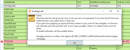

drjea2010 Posted January 14, 2022 Author Posted January 14, 2022 Ok, I took a break from this issue and am now returning to it. I dug deeper and found this error message in my module info/notes: "Invalid CRC, module might have been tampered" I haven't messed with it at all, but I can't for the life of me figure out where--in the vastness of cyberspace--I can find a NEW, CORRECT Nostalgia.ahk (or even whatever it says above it was looking for) that will work. Can anyone help by pointing me in the right direction? Where would I find this, or anything I can do to fix this error? Thanks in advance! Upon doing some more looking, if someone could just send me their Nostalgia.ahk v. 2.0.1 for Nostalgia 5.0, I would be deeply grateful. I'd swap it out and hopefully everything would be working finally.

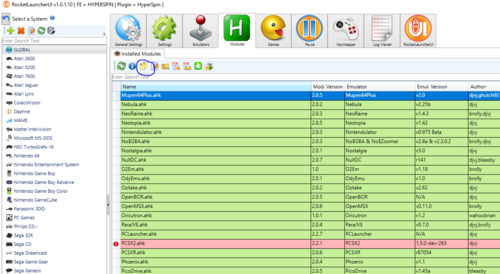

Spawk Posted January 16, 2022 Posted January 16, 2022 The module was written for that version. If it's green in RLUI then it is an official unedited module. See how my PCSX2 module is red, I made changes to it so it could load CHD files. You can click the 2x yellow pages (circled above) to see the module notes. These will usually have set-up tips in them. That last line may apply to you if you happened to try and run Nostalgia from another location previously... so it keeps trying to load settings from an old install?
