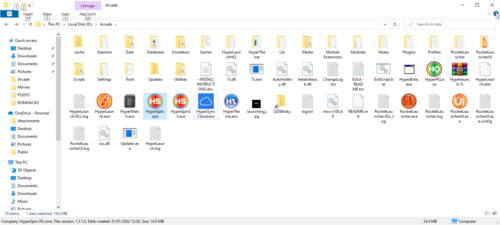

subzero1970 Posted January 31, 2022 Author Posted January 31, 2022 Thanks, that made it run, is there anything in this folder that shouldnt be there?
Creezz67 Posted January 31, 2022 Posted January 31, 2022 1 minute ago, subzero1970 said: Thanks, that made it run, is there anything in this folder that shouldnt be there? No, nothing that will make a difference to it loading.
Creezz67 Posted January 31, 2022 Posted January 31, 2022 1 minute ago, Creezz67 said: No, nothing that will make a difference to it loading. Also still set Hyperspin to run as admin and also RocketLauncherUI.exe With that file you can also upgrade to Windows 11 if you wanted to.

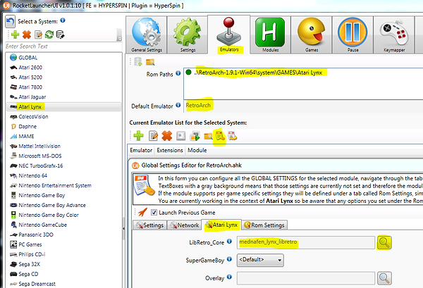

Spawk Posted January 31, 2022 Posted January 31, 2022 If launching through HS is not exactly like launching from RLUI then check these settings: Also, it is NOT recommended to "run as admin"... ok maybe if you installed HS to "c:\Program Files" or some other "windows" folder that needs special permission.
subzero1970 Posted January 31, 2022 Author Posted January 31, 2022 Sorry, its been a few years since i played with hyperspin, everything in that post you linked to looks the same to me

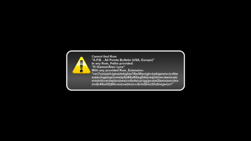

subzero1970 Posted January 31, 2022 Author Posted January 31, 2022 Don't seem to be able to get rocketlauncher to find the vectrex roms, it just keeps coming up with 1 rom called 'system'
Spawk Posted January 31, 2022 Posted January 31, 2022 I can try looking at a troubleshooting log if you like:
subzero1970 Posted January 31, 2022 Author Posted January 31, 2022 run a game via hyperpsin im assuming, yes?
Spawk Posted January 31, 2022 Posted January 31, 2022 It doesn't really show an error. It runs for about 10 seconds and then you hit "esc"... This is launched from RLUI? Try a different game than APB through HS and see if the log changes.

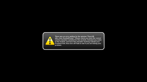

Spawk Posted January 31, 2022 Posted January 31, 2022 That one surely shows an error waiting for the "window class" name. You are using a standalone mednafen on that one though so there may be an updated module on the RL forums somewhere. You will probably have to fix each system that isn't working separately. Start with systems that use RA. mednafen_lynx works great for me:
subzero1970 Posted January 31, 2022 Author Posted January 31, 2022 what i cant get my head around is that some work in RL (daphne for instance) but wont run via hyperspin
subzero1970 Posted January 31, 2022 Author Posted January 31, 2022 ok, heres an odd one, so i can load a saturn game from RL but when it finally launches, the window is for the atari lynx...... im confused
Spawk Posted January 31, 2022 Posted January 31, 2022 14 minutes ago, subzero1970 said: what i cant get my head around is that some work in RL (daphne for instance) but wont run via hyperspin Again, I can only revert back to my original post. If it's not exactly the same in HS as RL then you are just not set up correctly. That's all HS does is "call" RL. Check those settings again. They are the only settings that connect HS/RL. Make sure they are exactly (with your own paths obviously) as shown. These kind of setups are very tempermental, one little setting somewhere can affect a lot.
