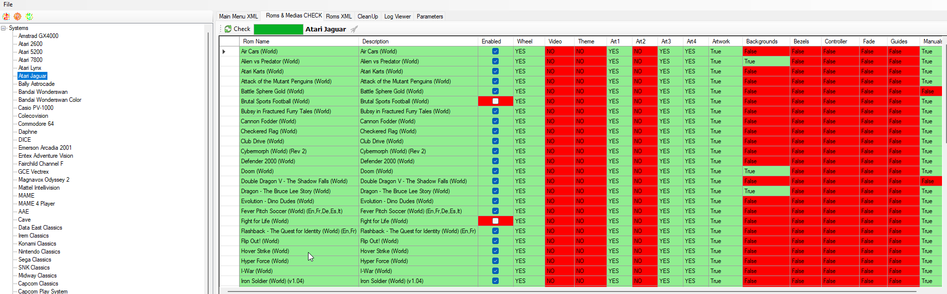

Circling back to this for closure, I moved all of my marquee folders to use Artwork1 instead, Now when using hypertools the status shows artwork 1 has a marquee.....except for my AAE system....no idea what's going on there, but the rest work
