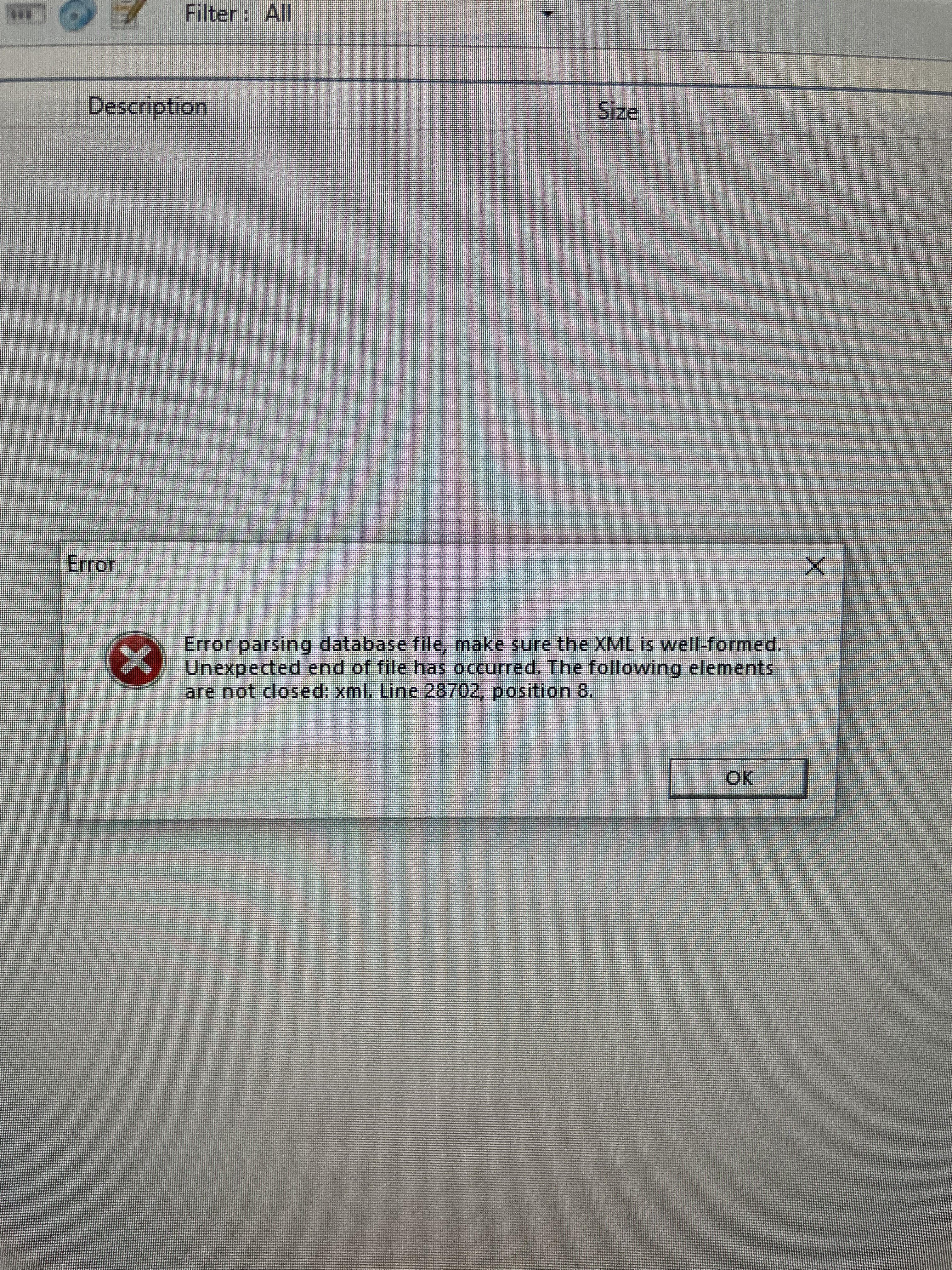

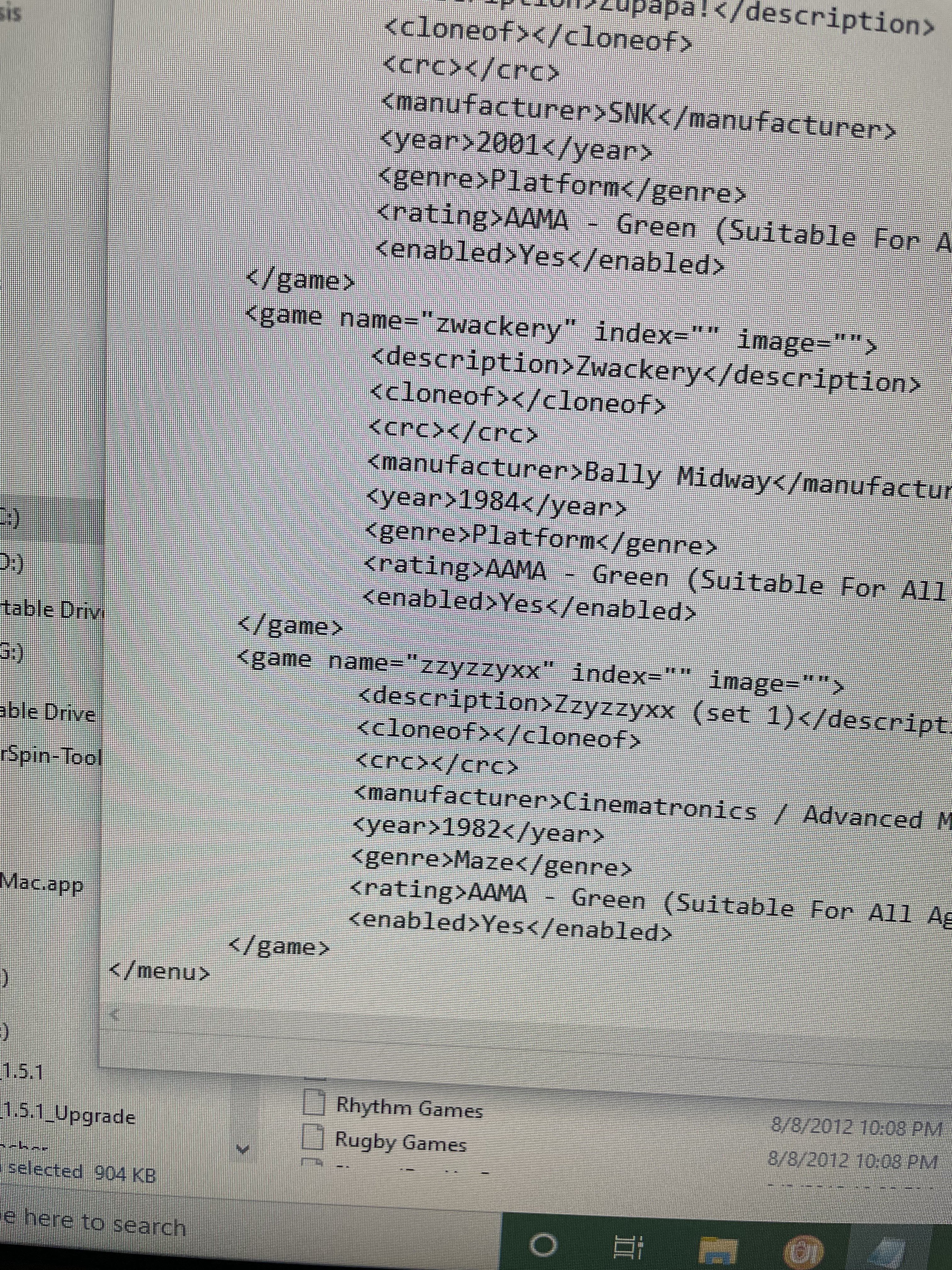

fitz73 Posted November 11, 2022 Posted November 11, 2022 I am trying to load MAME games in RocketLauncherUI. I am getting this error: Error parsing database file, make sure the XML is well-formed. Unexpected end of file has occurred. The following elements are not closed: xml. Line 28702, position 8. The thing is, the elements ARE closed. Line 28702 is the last line in the attached MAME database. You can see, it says </menu> so why does RL think it is open? Any help...please?
floatingyeti Posted November 11, 2022 Posted November 11, 2022 Open the xml file in Notepad++ so you can see what's on line 28702. It might not be the last line in the xml.
Andyman Posted November 12, 2022 Posted November 12, 2022 You can also compare to the known-good MAME XML databases here: http://retrofe.nl/Download/XML/ or just use one of those instead.
