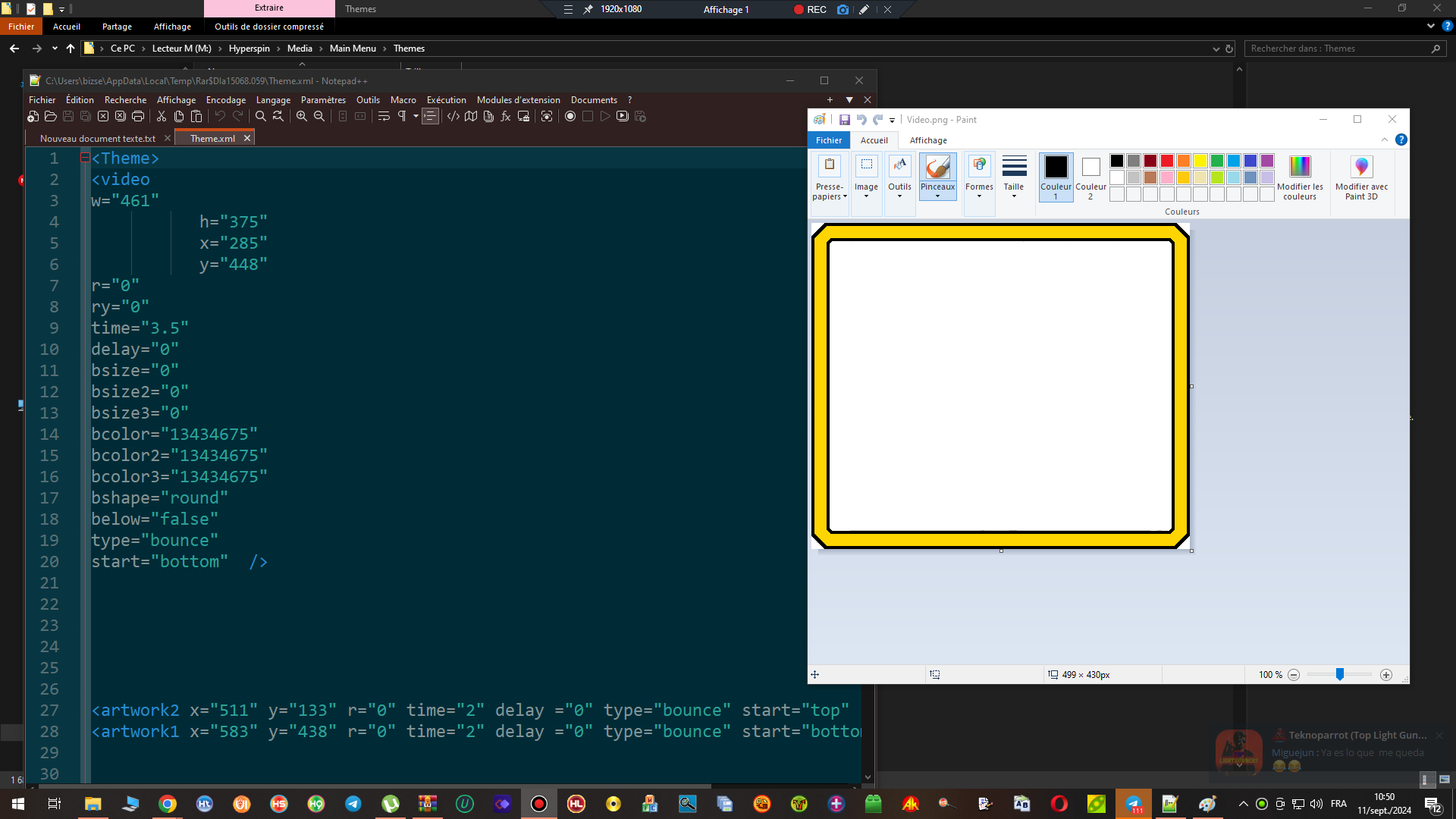

jesfknkrys Posted September 11, 2024 Posted September 11, 2024 Hi Andyman, HyperTheme uses the HEX color code on it's frontend, the color is then saved in the Theme xml in decimal format. You can set your Windows Calculator to "Programmer", select "DEC" and type in the color code from the XML file and you can view the HEX value. Calculator: Hex to DEC
