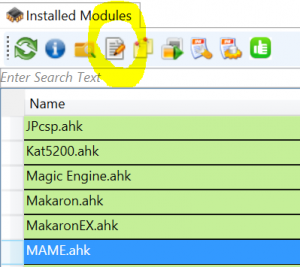

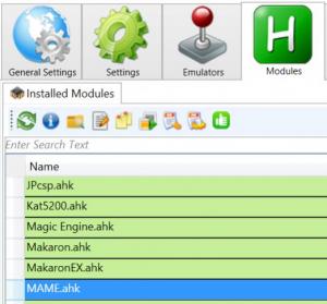

  1. Step 1 - Open up Hyperlaunch HQ, select the Global tab on the top left and click on Modules. Then, highlight the MAME.ahk script below and open the editor above at the top left of the screen.

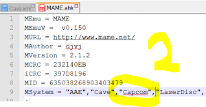

  2. Step 2 - add the manufacturer name of your new MAME dependent system. For example, if you are adding a new Technos Japan section for Ninja Gaiden. Call it whatever you like!
  3. Step 3 - close HyperlaunchHQ and restart to see your associated module.

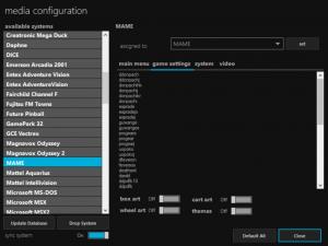

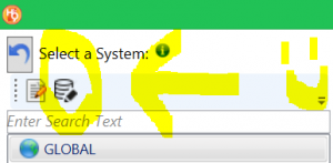

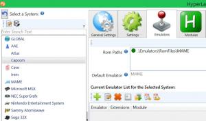

  4. Step 4 - select your new system or manufacturer then click the magnifying glass and double click on MAME.
  5. Step 5 - click on the green plus sign and direct MAME to your MAME rom directory.

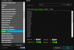

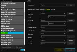

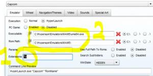

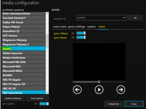

    1. Step 6 - confirm that the same information here is in HyperHQ.
    2. Step 7 - Confirm the paths and extension is either zip or 7z to match your romset.

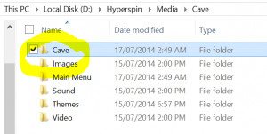

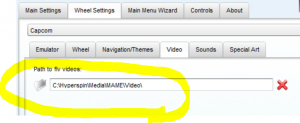

    3. Step 8 - direct your videos to the folder where you keep your MAME videos. If you have no artwork or videos installed yet or want a fresh set just for this system/ manufacturer/ genre then keep reading below.

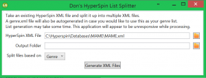

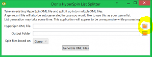

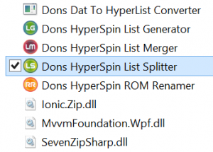

  1. Step 1 - open the Don's Hyperspin Tools zip file and extract it then start the List Splitter
  2. Step 2 - click on the browse button at the end of the HyperSpin XML File field

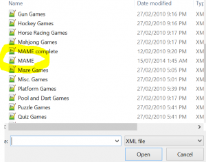

  3. Step 3 - click on the file named MAME and click open

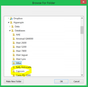

  4. Step 4 - now click on the browse button at the end of the Output Folder
  5. Step 5 - find the the system or manufacturer you just created and click ok

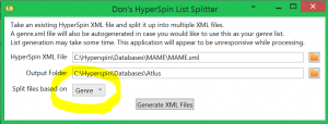

  6. Step 6 - change this dropdown menu to manufacturer if you are making a list for Midway or Capcom etc then click Generate XML Files

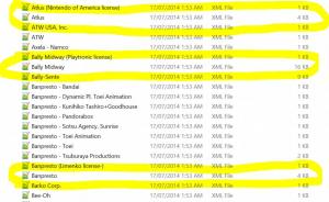

  8. Step 8 - wait for about 20 seconds and then check the folder

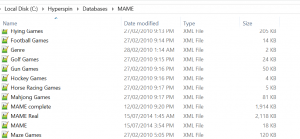

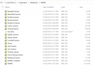

  9. Step 9 - copy and paste the list you are creating into the folder and change it to the same name as the folder and system in hyperlaunch HQ or HyperHQ
Well done! You have just created your custom list that is ready to run in Hyperspin!

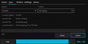

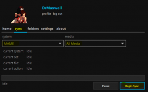

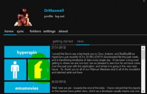

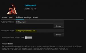

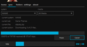

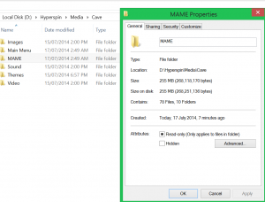

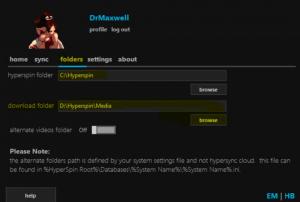

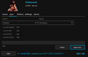

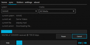

This next step is straightforward. I'll make a video of it tomorrow when I wake up, but I'm happy with the results and ease of it. Basically you generated a part of the original MAME XML and if we feed our new list into Hypersync it won't recognize the system because it is named something different, for example, "Capcom". So simply take that list you made and change the name to MAME.xml, then put it back into Hyperspin/Databases/MAME/ folder. Turn on hypersync, pick what you need for the system, then before you sync, change the directory to output into your "Capcom" folder.
This will generate a MAME folder with all the artwork for the roms listed in your custom XML. Saving you the hassle of matching themes, artwork and video for newly created systems. I just wish the same were true for MESS systems; it is a pity the naming conventions are different!

I was limited to 30 attachments for the initial post; I wanted to show the final step in much greater detail, so here are some screen shots of the process:

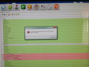

Thanks for the guide DrMaxwell, it seems pretty straightforward but for some reason I have an issue!
When I click on the 'Edit Module with your prefers editor' an error message pops up saying 'you don't have an editor set, make sure you set on under the HyperLaunchHQ tab.'
I've no idea what this means as I can't find an option to select 'on' in the HyperLaunch HQ tab.
Would you be so kind to guide me in the right direction with this?
Appreciate the guide, thanks in advance :-)
It's a typo! Should say "make sure you set one under the HyperLaunch HQ tab" i.e. make sure you set up an editor that HLHQ will use to open up the module.

It's a setting in the tab called "HyperLaunch HQ"', like the message box says. And yes, notepad++ is what you need.
