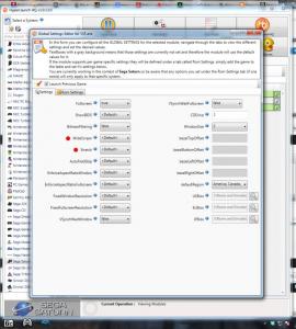

goldseal99 Posted July 20, 2014 Posted July 20, 2014 hello guys this is prob an old question I have looked around. How do I stop hyperspin changing the settings in ssf it keeps changing the 16.9 setting I tick the box in the emu hyperspin it unticks its like having a fight with it. is there suppose to be a ssf.ini file in the module folder? I just have the ahk and isd
JoeC3109 Posted July 20, 2014 Posted July 20, 2014 It might help to take a look in your SSF EMU folder. Somewhere in there, there is a folder with configs/ini with each game you have played in there. If you delete all the configs, you essentially let Hyperlaunch's settings become the default, which I imagine is what you want. SSF will then have configs in there based on the settings you have set.
gigapig Posted July 20, 2014 Posted July 20, 2014 Have you made changes here also, if you make changes here they should, I assume, be written to the SSF.ini when or just before the game starts.
Nano Posted July 22, 2014 Posted July 22, 2014 Hi, SSF is the biggest pile of crap to work with. I had significant problems with it unlike any other emulator, even just configuring the damned controllers was hard but I managed to get two players working. I found two issues that caused problems you describe: First of all SSF makes a new config file for each rom you use, so when I kept testing the same ROM using changes to the ahk and the ini file it was simply ignoring them because it had an inherited config file that was generated upon first test. You will need to find and delete these until you have things the way you want them. Second the ahk file in Hyperlaunch is the one applying the settings, I found making changes to the ini file made no difference as some settings were flat out being overwritten by Hyperlaunch, to see and edit these settings you need to edit the ahk itself, try Notepad++. Make sure you back it up first though or comment out any lines you change and then copy paste them to edit. Something that might also relate to this is an issue I had in some roms the bottom third of the screen was being cut off (I found this in Panzer Dragoon and Virtual On). At first I blamed the screen ratio settings but this turned out to be an issue with compatability between the BIOS and the ROM region. I had some BIOS that promised to be region free when in fact it doesn't run PAL stuff properly at all. I had oringinally ripped my PAL versions (yes I actually own a Saturn with many games (go me!)), but using NTSC and then using the universal BIOS worked. This issue was a particular whore because I couldn't find any help with it anywhere online and no one else seemed to experiene it. If you want my SSF ahk or ini just let me know. I also managed to configure a second controller which was just painful given the bug in the latest version with configuring second controller. I had to map using keyboard codes!
gigapig Posted July 22, 2014 Posted July 22, 2014 Hi,I found two issues that caused problems you describe: First of all SSF makes a new config file for each rom you use Any idea where these are stored?
Polemicist Posted July 22, 2014 Posted July 22, 2014 I was under the impression that all these changes could be made in HyperLaunchHQ rather than changing ini files etc?
Nano Posted July 22, 2014 Posted July 22, 2014 Any idea where these are stored? For me: \Hyperspin\Emulators\SSF_012_beta_R4\Setting\Saturn Also check \Hyperspin\Hyperlaunch\Modules\SSF\SSF.ahk settingsFile := modulePath . "\" . moduleName . ".ini" Fullscreen := IniReadCheck(settingsFile, "Settings", "Fullscreen","true",,1) ShowBIOS := IniReadCheck(settingsFile, "Settings", "ShowBIOS","false",,1) BilinearFiltering := IniReadCheck(settingsFile, "Settings", "BilinearFiltering","true",,1) vSync := IniReadCheck(settingsFile, "Settings", "vSync","true",,1) WideScreen := IniReadCheck(settingsFile, "Settings", "WideScreen","false",,1) This is what works for me.
