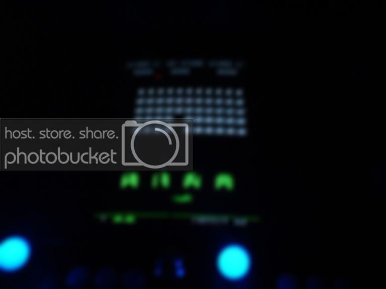

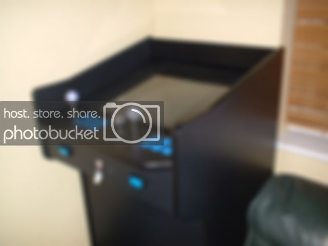

ericleroi Posted August 17, 2014 Posted August 17, 2014 I used smoked, toughened glass on my very first cab (old pictures - the only ones I have unfortunately): It had a CRT in it but I actually found that the darker glass gave a really good contrast. I'm not sure how you would fare with an LED but I would anticipate that it would potentially improve things.
