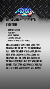

dark13 Posted August 29, 2014 Posted August 29, 2014 The question is really simple... is it possible to generate, in some ways, an xml with the same structure of the posted image from hyperspin's .xmls or emulators .dat? More infos I can get the better it is It may seems a crazy question but... well, I've found a way to batch these kind of .xml in photoshop to create info artworks. You can create layout then assign variables to text layers and automatically create images from simple data Automatizing infopanels creation from .csv files for HTPCs themes (look at infopanel tutorial.zip on the ftp in dark13 folder) PNGs to SWFs automatized flash scripts Hyperspin Wheelset automatized template (photoshop's variables + batch) Aeon nox 4.13 W.I.P. hyperspin skin

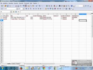

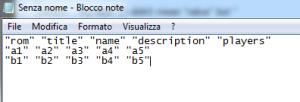

dark13 Posted August 30, 2014 Author Posted August 30, 2014 More infos in HL data folder, looks good The problem is I need to batch conversion, dealing with mame's database would be an hell Photoshop want a file like the one attached. Basically something like this (consider that file is "broken" in years variables, I should have told openoffice to consider it as plain text) "romname1" "title1" "genre1" "ratings1" "romname2" "title2" genre2" "ratings2" (open the file in notepad to see plain text or openoffice to have tabbed version, easier to read) The REALLY good thing is once you have a .csv like this you can batch a whole lot of nice things. Let's just imagine: you have a 5 stars images (0.png,0.1png,0.2png....5.png) and your csv has a variable (going from 0 to 5), you can automatically have a rating png's artworks for your theme. Infact it is possible to use the first variable (rom's name) as file's name. You can batch everything that would normally include boring repetitions. What about producer/manufacturer artworks (that clearly are not as many as rom's number): you can create the artworks then batch it to match roms. No boring files renaming Moreover you can easily deal with colums in openoffice, if you don't need a variable you can simply delete the column or create a new one. Probably I should make a video of the process SNK Neo Geo - Copia3csv.zip Automatizing infopanels creation from .csv files for HTPCs themes (look at infopanel tutorial.zip on the ftp in dark13 folder) PNGs to SWFs automatized flash scripts Hyperspin Wheelset automatized template (photoshop's variables + batch) Aeon nox 4.13 W.I.P. hyperspin skin

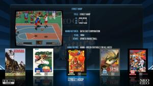

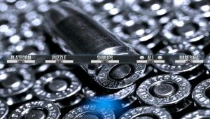

dark13 Posted August 31, 2014 Author Posted August 31, 2014 Have to try it. If you have time I would be glad if you could convert it for me as i'm busy preparing graphics . Obviusly these .csv could be used for A LOT of thems, including infopanel in official hyperspin themes (replacement on the low screen zone where classic HS info appear) But here's a little WIP of what i'm working too. Screenshot2 is a test for the main wheel and actually it is neo geo's genre wheel (taller pngs for genre to change wheel position) Info layout obviusly is still a mess, it is only a quick test for data to image exporting Number of players is a variable and it's on the info artwork layer. Automatizing infopanels creation from .csv files for HTPCs themes (look at infopanel tutorial.zip on the ftp in dark13 folder) PNGs to SWFs automatized flash scripts Hyperspin Wheelset automatized template (photoshop's variables + batch) Aeon nox 4.13 W.I.P. hyperspin skin

ghutch92 Posted September 1, 2014 Posted September 1, 2014 I'll obviously have to manually correct some flaws as these script cannot be 100% "perfect" but can I ask you another favour? It seems impossibile to export empty cells from openoffice as "", could you modify the script to add - or a space when a field is empty? Maybe ... like it's already in some hyperlaunch empty field. I have no idea what you are talking about? The files I uploaded are separated by a tab space. They look fine when I open them using excel. I don't know what you mean by export. The easiest way to fill in the empty cells in the files I uploaded would be to do a replace all on \t\t with \t...\t Is there a "general" or "official" rating for hyperspin? HS in neogeo xml use AAMA while hyperlaunch seems to not include ratings (is it coded into "fade"? It appear when fade is enable) Sure there are lots of ratings. The ratings hyperlaunch uses I believe come from the hyperspin xml files. For a list of HyperSpin accepted rating see this post. Score included in hyperlaunch is taken from the site in the url, right? I would prefer a 100% based score (you know, zzap! freak )... maybe metacritic or there's a better site? The scores are on 0 to 5 scale. To convert it to a 0 to 100 scale insert a new column and make a formula like =IF(ISNUMBER(A2),A2*20,"...") How to Install HyperSpin and more RocketLauncher HyperSpin Startup Script
dark13 Posted September 1, 2014 Author Posted September 1, 2014 I have no idea what you are talking about? The files I uploaded are separated by a tab space. They look fine when I open them using excel. I don't know what you mean by export. The easiest way to fill in the empty cells in the files I uploaded would be to do a replace all on \t\t with \t...\t Photoshop does not read your files. It uses "VALUE" as field separator, it ignores TAB. If I try to load your files (remaned to .txt or .csv) it says there are too many variables in the first line. So I opened it in openoffice and exported with " as cells separator. The only problems is openoffice does not import empty cells as "" but uses TAB If you have a 6 line document with an empty cell on a line photoshop will read only 5 variables instead of 6 on that line and will not load data -.- Sure there are lots of ratings. The ratings hyperlaunch uses I believe come from the hyperspin xml files. For a list of HyperSpin accepted rating see this post. Thank you. I asked because to make layouts I want ratings with the same name on every databases so everyone can easily create rating png's set usable trought different systems The scores are on 0 to 5 scale. To convert it to a 0 to 100 scale insert a new column and make a formula like =IF(ISNUMBER(A2),A2*20,"...") Again, thank you EDIT: I now noticed your file list 99 games while the .csv I made from neogeo HS xml's list 140 roms. Script issue or not every neo geo game is listed in hyperlaunch .ini?!? Automatizing infopanels creation from .csv files for HTPCs themes (look at infopanel tutorial.zip on the ftp in dark13 folder) PNGs to SWFs automatized flash scripts Hyperspin Wheelset automatized template (photoshop's variables + batch) Aeon nox 4.13 W.I.P. hyperspin skin

dark13 Posted September 1, 2014 Author Posted September 1, 2014 @ghutch92 Ahem... my fault I didn't mean "value" but " when opened in notepad the files must look like this [ATTACH=CONFIG]44344[/ATTACH Obviously i can convert "VALUE" into " but some arguments seems to stay "open" es: first line is rom_name§Publisher§Developer§Released§Systems§Genre§Perspective§Score§Controls§Players§Rating§Url§Description When it should be §rom_name§Publisher§Developer§Released§Systems§Genre§Perspective§Score§Controls§Players§Rating§Url§Description§ Anyway, reading bleasby's consideration probably is better to use latest hyperspin's .xml as base Automatizing infopanels creation from .csv files for HTPCs themes (look at infopanel tutorial.zip on the ftp in dark13 folder) PNGs to SWFs automatized flash scripts Hyperspin Wheelset automatized template (photoshop's variables + batch) Aeon nox 4.13 W.I.P. hyperspin skin
ghutch92 Posted September 1, 2014 Posted September 1, 2014 I have no interest in editing that particular bit of code. I added § before and after all the values like you had suggested. §rom_name§Publisher§Developer§Released§Systems§Gen re§Perspective§Score§Controls§Players§Rating§Url§D escription§ How to Install HyperSpin and more RocketLauncher HyperSpin Startup Script
