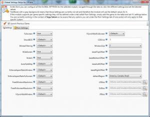

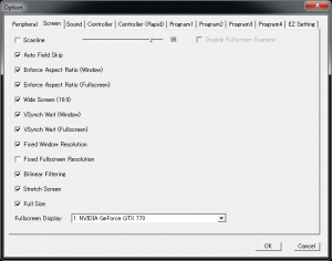

gigapig Posted September 11, 2014 Posted September 11, 2014 You've never had much luck with SSF have you no need for stress, grab a drink, sit down, relax and let try to fix this. I noticed for the first time that there's no resolution setting in the options, but anyway. Set everything to defaults in HLHQ. And here are the settings I used to get widescreen. You can do it while the emu is running, just hit alt-enter to get the menus; and if your images are zipped try a small game like Battle Monsters. Looks okay with Sweetfx scanlines, but I may go back to 4:3.

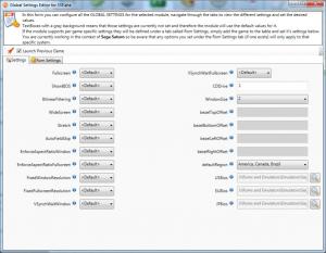

gigapig Posted September 11, 2014 Posted September 11, 2014 I have carried on messing with this and it does seem to be best to set it in HLHQ if you want it right to the edge as some of those settings in the emu just don't stick; unless it's changing when I press alt-enter. So add these also.
