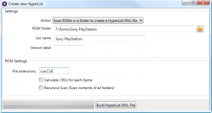

rfancella Posted October 6, 2014 Posted October 6, 2014 The thread says it all.I ask because I am trying to have my Sega CD and ps 1 games show just the .cue files for each game and not the .cue and .bin files. Does anyone know how to do this? Thanks for the help. Sincerely, Arcadedude82 Using HyperTools is the easiest way to do this. Just launch "Create New HyperList.exe". Choose your ROM Folder. It will fill in all possible extensions. Remove all but cue and/or CUE. Turn off Calculate CRCs... Hit the "Build HyperList XML File" button. Thanks, Ron Code Monkey and all around Command Line geek!If you like what someone has said or done for you, be sure and 'Thank' them. And if they changed your life, send them a Beer!
