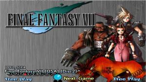

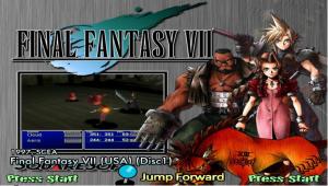

pavlovtiger Posted October 7, 2014 Posted October 7, 2014 Ugh. Hoping for a response to this this time, as last time it happened I got no replies and my issue magically resolved itself. I'll offer pictorial evidence of my problem this time as well. So. Here's what my Final Fantasy VII entries in the Playstation wheel are meant to look like: [attachment=14716:40959.attach] That is my Disc 1 wheel entry. Here is what Disc 2 and Disc 3 both look like now, after I tried making my own video clips for them so they would show gameplay which actually occurs on those discs: [attachment=14717:40960.attach] As you can see, the very frame the video clip lives in has gone away and left no forwarding address. Disc 2 and 3 both exhibit this behavior and, just like with the 4-disc Geppy-X game, replacing the stock video clips does not bring the frames back, they are gone. I am baffled by this. I want to get the videos back (the ones I made, if at all possible) and more importantly, to understand why this happens so I can stop it happening anymore.

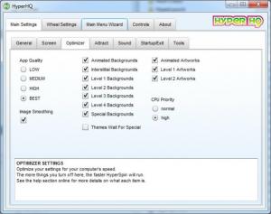

gigapig Posted October 13, 2014 Posted October 13, 2014 You might also want to try this below, I have unchecked "Themes wait for special" and if that doesn't work try lowing the settings in the optimizer
pavlovtiger Posted October 13, 2014 Author Posted October 13, 2014 Ah, here's my settings.ini then: [Main] Hyperlaunch_Path=M:\Hyperspin\HyperLaunch\ Menu_Mode=multi Single_Mode_Name=NEC TurboGrafx-CD Enable_Exit_Menu=true Enable_Exit=true Exit_Default=yes Exit_Action=exit Version=1.0.0.0 Last_System=Sony PlayStation Hyperlaunch_Path=M:\Hyperspin\HyperLaunch\ [Resolution] FullScreen=false Width=800 Height=600 Scanlines_Active=false Scanlines_Image= Scanlines_Scale=2 Scanlines_Alpha=0.1 [Optimizer] CPU_Priority=high Quality=MEDIUM Image_Smoothing=true Animated_Backgrounds=true Inter_Backgrounds=true Level1_Backgrounds=true Level2_Backgrounds=true Level3_Backgrounds=true Level4_Backgrounds=true Special_Backgrounds=true Wait_For_Special=false Animated_Artworks=true Level1_Artworks=true Level2_Artworks=true [introVideo] Use_Intro=true Stop_On_Keypress=true [sound] Master_Volume=100 Video_Volume=100 Wheel_Volume=30 Interface_Volume=60 [AttractMode] Active=true Time=60 MaxSpinTime=10 HyperSpin=true Wait_For_Video=false [Keyboard] Key_Delay=true [P1 Controls] Start=13 Exit=27 Up=38 Down=40 SkipUp=37 SkipDown=39 SkipUpNumber=70 SkipDownNumber=86 HyperSpin=32 Genre=71 Favorites=76 [P2 Controls] Start=69 Exit=81 Up=87 Down=83 SkipUp=65 SkipDown=68 SkipUpNumber=74 SkipDownNumber=77 HyperSpin=88 Genre=72 Favorites=90 [P1 Joystick] Enabled=false Joy=0 Threshold=40 Start=Button_1 Exit=Button_2 Up=Analog_Up Down=Analog_Down SkipUp=Analog_Left SkipDown=Analog_Right SkipUpNumber=Button_3 SkipDownNumber=Button_4 HyperSpin=Button_5 Genre=Button_6 Favorites=Button_7 [P2 Joystick] Enabled=false Joy=1 Threshold=40 Start=Button_1 Exit=Button_2 Up=Analog_Up Down=Analog_Down SkipUp=Analog_Left SkipDown=Analog_Right SkipUpNumber=Button_3 SkipDownNumber=Button_4 HyperSpin=Button_5 Genre=Button_6 Favorites=Button_7 [Trackball] Enabled=false Sensitivity=90 [spinner] Enabled=false Sensitivity=90 [startup Program] Executable= Paramaters= Working_Directory= WinState= [Exit Program] Executable= Paramaters= Working_Directory= WinState=NORMAL [LEDBlinky] Active=false Path= [HiScore] Active=false Y=550 Delay=2
