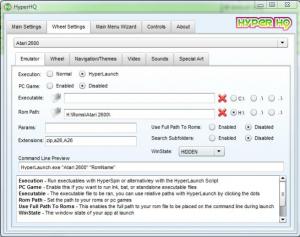

Thomas,
Here is my current setup that works for me.
HyperHQ:
HLHQ (HyperLaunchHQ) GLOBAL Emulator (Stella):
HLHQ Atari 2600 settings:
HLHQ My Rom (games) location:
HLHQ Default Emulator:
HLHQ Game Audit (all green and ready to test):
Let me know how you get along with these settings.
Thanks,
Ron
PS: There is another thread about Stella going right now here: http://www.hyperspin-fe.com/forum/showthread.php?37216-A2600-Driving-me-crazy-with-launch-I-have-Hyperlaunch-disabled&p=345549&viewfull=1#post345549
Thomas,
HyperHQ:
[ATTACH=CONFIG]45905[/ATTACH]

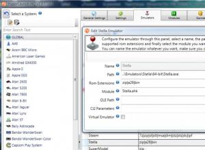

[ATTACH=CONFIG]45906[/ATTACH]

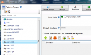

[ATTACH=CONFIG]45907[/ATTACH]

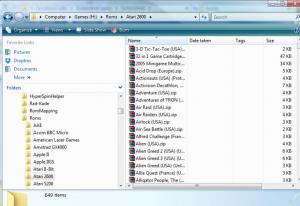

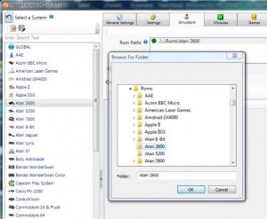

[ATTACH=CONFIG]45908[/ATTACH]
[ATTACH=CONFIG]45909[/ATTACH]

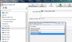

[ATTACH=CONFIG]45910[/ATTACH]

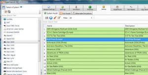

[ATTACH=CONFIG]45911[/ATTACH]
Thanks,
Ron

I remember reading about approaching this 2 different ways...
Games won't launch and show up red/ not found in HLHQ.
Wondering if I have my settings in HyperHQ are ok?...any help/info on this appreciated.
Also, anything needs to be set or done in HyperLaunchHQ?
thomas
