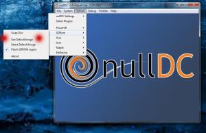

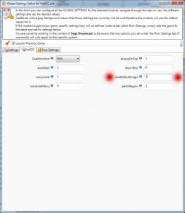

That's quite common and can be a pain especially if your at full screen, so it's best to have NullDC in a window when setting up so you can close it. Press alt-enter to switch to windowed.
You need to uncheck "Use default image", but unfortunately you need that checked for Hyperlaunch to load the game image. If you have it set in Hyperlaunch to load the default image, every time you uncheck it in NullDC, HyperLaunch will change it back when you run a game, unless you change it in Global Module settings (See Below.)
It's best to just leave it, get it setup and as long as you don't run NullDC on it's own again, you won't notice it.
Maybe things are different if using DT Lite, but I don't use it for Dreamcast.

Hi gig I wonder if you can help here...
I had this img plugin error and worked out that if you turned off use default image the error stopped. I'm using the hyperspin ready dreamcast set so when I found a game created this error I was confused.
If I run 18 wheeler from HL it works
If I run fast striker it fails.
All roms are 7zip. The 18 wheeler is a gdi but the fast striker is ccd and img.
I searched the forum and was very surprised to hear that you don't use daemon tools to mount the image. I thought that was a must for disc images regardless of format.
Would you mind explaining how nulldc reads the game under your setup?
Cheers
