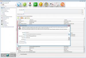

rfancella Posted May 14, 2014 Posted May 14, 2014 Did anyone get this working? I can get commadore 64 working with winvice but commodore 16 plus4 games use another emu that comes with winvice. I've tried to set it up a few ways but no luck just yet. So has anyone done this successfully? Thanks Affirmative. I do have it running using the newest WinVice module. It's a little different getting it setup because it uses a different exe, but this is how to do it. Make sure you have the latest and greatest modules. Add the system to your wheel in HyperHQ. Be sure and name it "Commodore 16 & Plus4" so HyperLaunch will see it. Launch HyperLaunchHQ. Make sure Global is selected on the top left. Then click on Emulators. Hit the Green Plus icon to Add A New Emulator. I called mine (Name) "WinVICE (Commodore 16 & Plus4)". The Path should be to your xplus4.exe in your WinVICE emulator folder. My Rom Extensions are "7z|zip|bin". The Module is WinVICE.ahk. This will give you a Global Emulator for the Commodore 16 & Plus4. Setup the rest as you should. Give this a whirl and let me know. Thanks, Ron Code Monkey and all around Command Line geek!If you like what someone has said or done for you, be sure and 'Thank' them. And if they changed your life, send them a Beer!

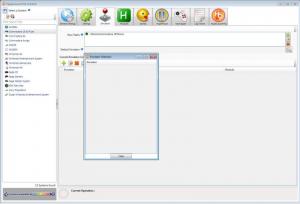

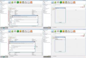

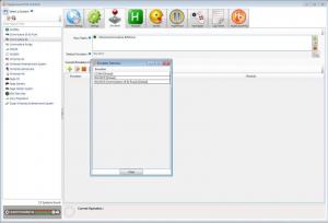

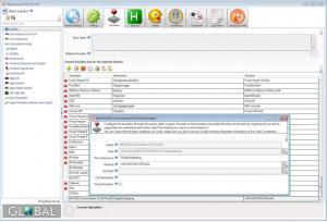

StevieMac Posted May 19, 2014 Posted May 19, 2014 Hey Ron I've made a few changes & now HLHQ doesn't have a problem with them using the same AHK file but I'm still not able to set a Default Emu as none appear in the list Check the screen shots attached. The C64 I can choose a Global for WinVICE & the C16 version but in the C16 nothing is shown in the Default list to choose.
rfancella Posted May 19, 2014 Posted May 19, 2014 Hey Ron I've made a few changes & now HLHQ doesn't have a problem with them using the same AHK file but I'm still not able to set a Default Emu as none appear in the listCheck the screen shots attached. The C64 I can choose a Global for WinVICE & the C16 version but in the C16 nothing is shown in the Default list to choose. [ATTACH=CONFIG]41190[/ATTACH] Sounds like you are getting close. I cannot make out the screen shots. Can you attach them individually please? Thanks, Ron Code Monkey and all around Command Line geek!If you like what someone has said or done for you, be sure and 'Thank' them. And if they changed your life, send them a Beer!
StevieMac Posted May 19, 2014 Posted May 19, 2014 Sorry Ron I didn't know the forum shrunk the sizes. I have noticed when I select the module ahk file for C64 HLHQ puts in the path as WinVICE.ahk but when I do exactly the same for C16 it puts ..\WinVICE\WinVICE.ahk as the path. You can see that in the images above.
rfancella Posted May 19, 2014 Posted May 19, 2014 Sorry Ron I didn't know the forum shrunk the sizes. Cool. Thank you! That looks great! Perfect! What WinVICE.ahk module version are you using?? The newest version is 2.0.2... Thanks, Ron Code Monkey and all around Command Line geek!If you like what someone has said or done for you, be sure and 'Thank' them. And if they changed your life, send them a Beer!
