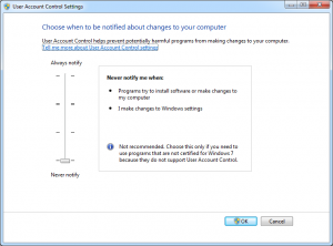

gigapig Posted January 4, 2015 Posted January 4, 2015 Here are the correct spellings for the systems. Sega SG-1000 NEC TurboGrafx-16 To get rid of the Fontregl.exe warning you need to set UAC or perhaps look to set it in the registry. For Windows 7 click start and type UAC in the box, this should pop up and set the slider to the bottom.

whyfacetw Posted January 12, 2015 Posted January 12, 2015 Hello. [Edit: Suppressing] UAC is not acceptable. What is Fontreg, why does it need administrative permissions, and how can I turn it off? It was not an issue in previous versions of hyperlaunch and I do not wish to use it. Thank you.
Guest Posted January 12, 2015 Posted January 12, 2015 whyfacetw said: Hello.[Edit: Suppressing] UAC is not acceptable. What is Fontreg, why does it need administrative permissions, and how can I turn it off? It was not an issue in previous versions of hyperlaunch and I do not wish to use it. Thank you. Fontreg registers the fonts that's HL uses with Windows. It's there to help you. You can of course manually add the font.
