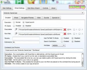

strawdog Posted January 11, 2015 Author Posted January 11, 2015 Thanks Giga, watched your vid again, set everything up and still having the same issue, here are some screengrabs, ive spent 3 nights on this ! if i had any hair left i would be pulling it out now!

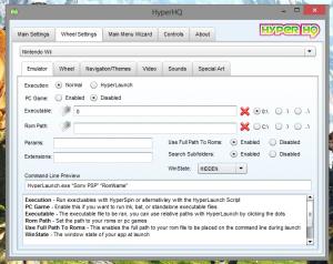

gigapig Posted January 11, 2015 Posted January 11, 2015 [ATTACH]49148[/ATTACH] Your execution is set to normal
FrankyRizzo Posted January 11, 2015 Posted January 11, 2015 I accidentally clicked that when I was taking the photo. It's changed back now. Was just trying to show I have it blank and it works
FrankyRizzo Posted January 11, 2015 Posted January 11, 2015 Wish I noticed that before I sent the photo.
