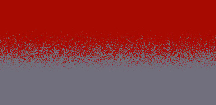

JayC Posted January 31, 2015 Posted January 31, 2015 There is another way as well that is similar, and very easy to control. Select Filter/Filter Gallery, then click on brush strokes and select Spatter. If you turn smoothness down and Spray Radius as high as you like you will get a similar effect. It blends pretty nicely. Only problem is that it doesn't work well on high resolution stuff, but it works pretty good on 1024 x 768 at least. I find that it might be a bit too grainy on the lowest smoothness setting, but try smoothness level 2 if you like it better. Here's a quick preview, took about 5 seconds to make: (Just a simple gradient with the splatter brush effect)
