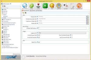

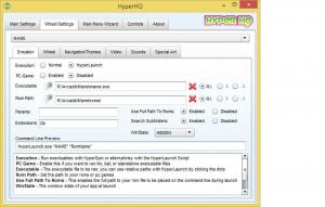

Jefferrari Posted February 26, 2015 Author Posted February 26, 2015 I have 1 of hyperhq and 2 of hyperlaunchq let me know if you see anything wrong here thanks for the help! I am using the path R:/ because all the emulators and roms are in my external hard drive....not sure if its a problem with the path or its probably something so stupid I'm doing wrong lol Just stressing out trying to figure it out!
gigapig Posted February 26, 2015 Posted February 26, 2015 Is HyperSpin etc also on the R drive? if not then your Mame Rom path is wrong in screen shot 1. Also for future reference, look at your screen shot 2, set logging level to Troubleshooting in case you need to post your HyperLaunch log. Edit:Also some of the system icons have not shown up, that's because you have named them incorrectly. EG, Gamecube should be Nintendo Gamecube. If in doubt look in the :HyperSpin\HyperLaunch\HyperLaunchHQ\Media\Icons, folder to see how the systems are spelt/spelled.
