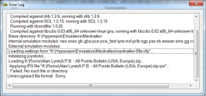

Ibanezmike Posted February 27, 2015 Author Posted February 27, 2015 Thanks for the quick reply. I have downloaded and fiddled around with MedGui1.99995 and keep getting this message: "This MedGui version is only compatible with Mednafen 0.9.XX or upper series. You have selected a incompatible rom or you have set a wrong option in the guui, press abort to see the log output or press OK to download the last Mednafen version." I will try to attach the error log but I have no idea if it will work or not. I have also clicked OK and it showed a progress bar and downloaded files from somewhere and put them in my mednafen folder but I still get the same message when I try again. I can ger Basketbrawl to work but I have tried around 20 others that give me the message stated earlier.

32assassin Posted February 28, 2015 Posted February 28, 2015 Ibanezmike said: I have tried launching alot of games from hyperspin but keep getting an error message saying the AHK file took too long to load or something, I can get the whole message if needed but the only game I have been able to get working is Basketbrawl. I don't think i mentioned this but I am trying to get the Atari Lynx working, if that makes a difference. I have tried putting the bios in a "firmware" folder in the mednafen directory but it comes up with an error message saying it needs to be in the mednafen directory. So I moved it to the mednafen root directory and it works with Basketbrawl and every other game I've tried gets the previous mentioned errors. the GUI you are trying to install is not going to fix your problems. load those games outside of Hyperspin, using the drag and drop method. if they load and play then they should also load and play in Hyperspin. second can you post your log, because I have to ask How old is your Hyperlaunch and module? the latest module should be looking for your bios in the firmware folder. line 107 Quote CheckFile(emuPath . "\firmware\lynxboot.img","Cannot find the Atari Lynx bios file required to use this system:`n" . emuPath . "\firmware\lynxboot.img")
