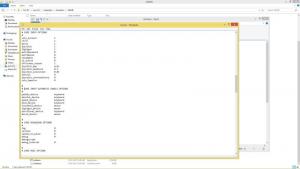

Jefferrari Posted March 6, 2015 Author Posted March 6, 2015 Copy of my mame.ini # # CORE INPUT OPTIONS # coin_lockout 1 ctrlr 1 mouse 1 joystick 1 lightgun 1 multikeyboard 0 multimouse 0 steadykey 0 ui_active 0 offscreen_reload 1 joystick_map auto joystick_deadzone 0.3 joystick_saturation 0.85 natural 0 joystick_contradictory 0 coin_impulse 0 # # CORE INPUT AUTOMATIC ENABLE OPTIONS # paddle_device keyboard adstick_device keyboard pedal_device keyboard dial_device keyboard trackball_device mouse lightgun_device mouse positional_device keyboard mouse_device mouse

vampirolatino2 Posted March 7, 2015 Posted March 7, 2015 # # CORE INPUT AUTOMATIC ENABLE OPTIONS # paddle_device keyboard adstick_device keyboard pedal_device keyboard dial_device keyboard trackball_device mouse lightgun_device mouse positional_device keyboard mouse_device mouse THE ERROR

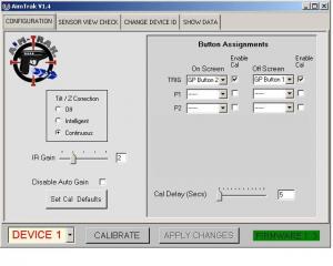

alcoatjez Posted March 11, 2015 Posted March 11, 2015 What kind of lightgun do you have? In the Aimtrak software you can set up the buttons.
Jefferrari Posted March 11, 2015 Author Posted March 11, 2015 I have the aimtrak light gun, but somewhat confused on how to configure the buttons on it...please tell me you know how to use not only the trigger button but the side buttons aswell lol
alcoatjez Posted March 12, 2015 Posted March 12, 2015 In the Aimtrak software you have to set the buttons on this screen:
